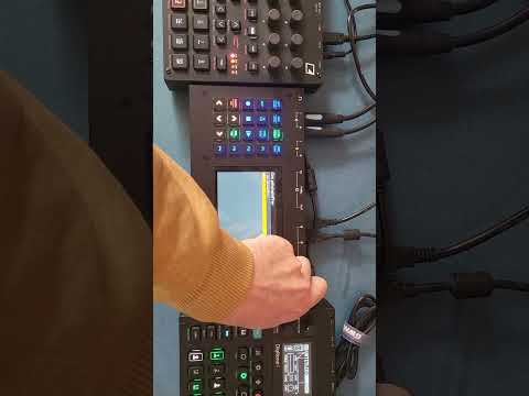

That’s crazy ! =D so cool !!! I bought a Xone DB4 to be able to mix and FX my main out for my live, zynthian beat every thing !
Thank you a lot ![]()
No audio cables, just usb is really cool ![]()
Do you think Is it possible to transmit at the same time the midi ? (on the same track)
Yep. Done that…
