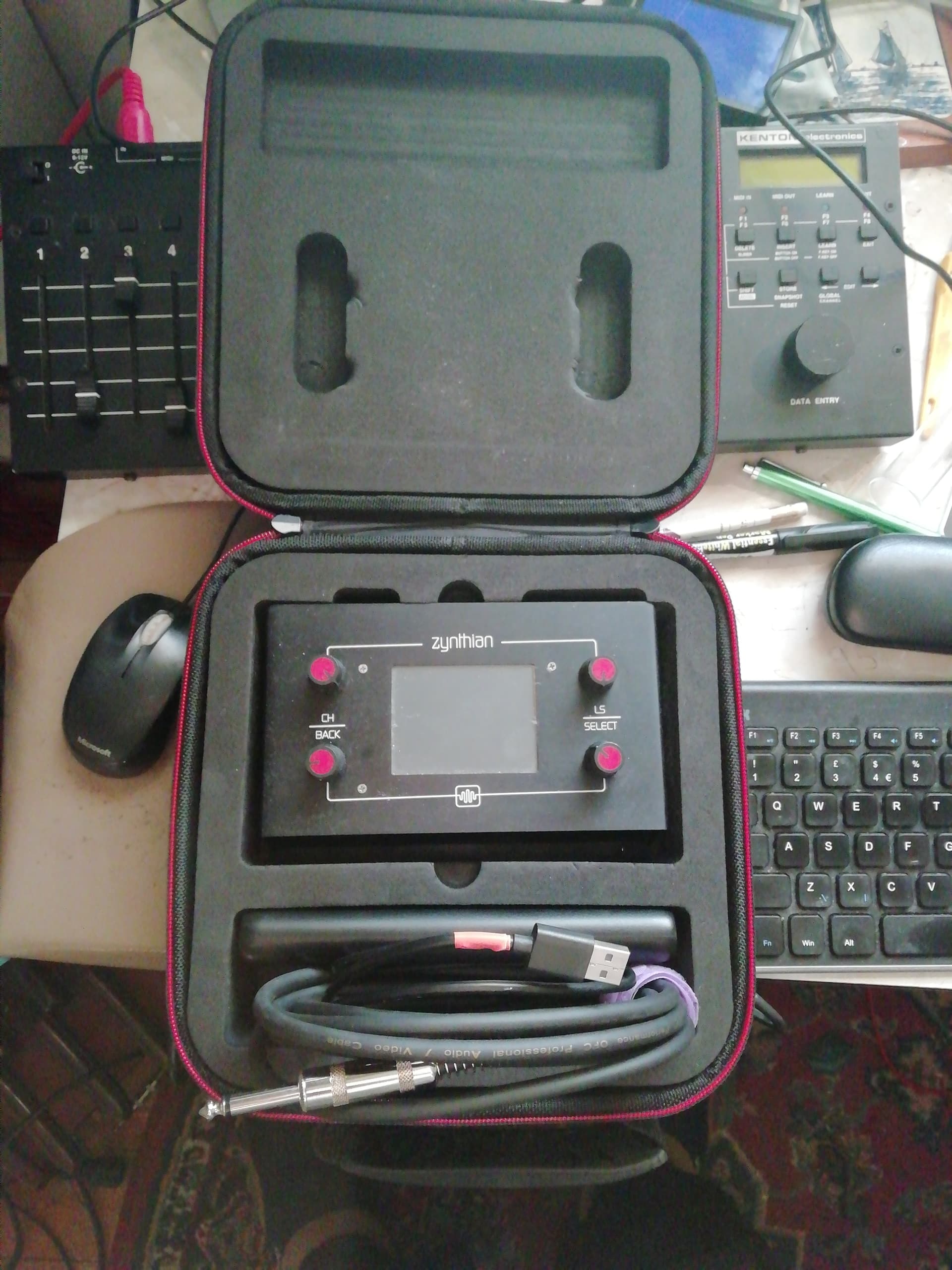

I should design and manufacture a nice suitcase for V5 … it’s a pity we don’t have one yet!
