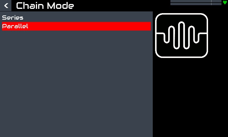

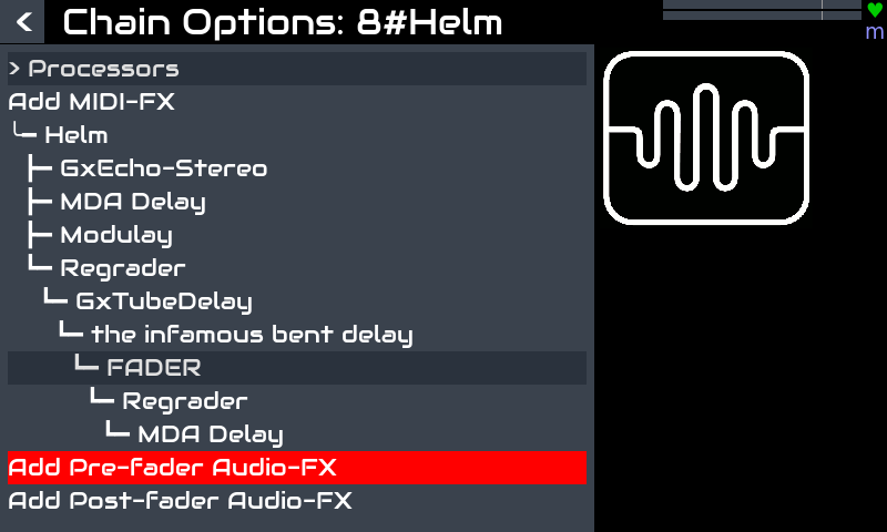

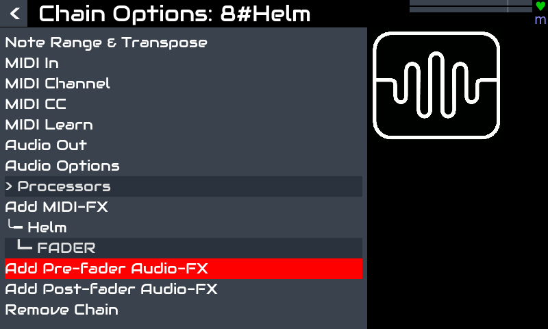

It builds up from the submenus of the chain in the Chain options…
It’s not a particular slick operation in itself but as with so much that has been refined, the mixer audio sub system has undergone much work to make this sort of context efficient.
Pretty will come later…
The GUI on MOD UI was a work of beauty but all really just broke down into a similar structure of connections within the jack universe, so there shouldn’t be anything in the MOD file that can’t be done, and if there is I’m sure people would like to hear about it.
I don’t know if there is any kind of tooling available to transfer patches. It should only be a one way, one time operation.

Be nice if after adding a chain it didn’t return to the mixer page. You have to navigate back in to build something semi involved.
The chain is represented in a kind of tree like structure. In the example @wyleu showed, there is a synth processor (Helm), followed by 4 audio processors in parallel (GxEcho-Stereo, MDA Delay, Modulay, Regrader) followed by an audio processor in series (GxTubeDelay) followed by an audio processor in series (the infamous beng delay) then the chain reaches the mixer strip indicated by the FADER and then it goes to an audio processor (Regrader) and then another audio process in series (MDA Delay).
The indentation shows whether processors are in parallel or series. All in parallel have the same indetation. The thick lines show audio path and thin lines show the MIDI path.
As @wyleu says, this isn’t very pretty and we have ideas to improve this. (Someone was going to look at that…) But it is functional.
When you move a processor it moves to the next slot in the chain, adding a slot if it is moving from a parallel position so that you can change the processor’s postion from parallel to series to parallel…
It would be nice to have a more graphical represenation of this and I would love for someone to design that. I don’t have the time.
