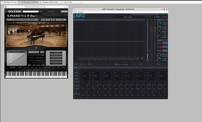

:brazil: While using Zynthian ORAM, I tried to open the graphical interface of some LV2 plugins directly from the Zynthian GUI, but the interface would not open.
The plugins were installed correctly and working, but Zynthian was launching them without their native graphical interface.
After investigating, I found that some plugins were configured in engine_config.json with:
"UI": null
even though they provided a native X11 GUI.
Changing this value to:
"UI": "X11UI"
allowed Zynthian to launch the plugin’s native graphical interface.
This solution does not require modifying Zynthian source code.

All of them opened their native GUI after changing:
"UI": null
to:
"UI": "X11UI"

Hi checked this 4 plugins and the only one that has the UI field to None is the first one (x42 IR Convolver). All the rest work fine for me.
Regarding the first one, it has the UI field to None because it has not a native GUI. What you get when setting the UI fields to “X11UI” is a generic UI auto-generated by Jalv. This could be useful in some cases, but normally we prefer to not have the generic UI enabled. Perhaps we could change this.
All the best,
Done!
I think this can’t harm:
  • Auto-generated GUIs have very low CPU impact.
  • Sometimes they can be useful.
  • It’s weird (and it feels wrong) having native GUIs for some plugins and not for others. If you are using VNC for adjusting parameters, having an autogenerated GUI is better than not having it.
  • Yes. they are mostly ugly and not very useful, but they doesn’t harm.
If some users prefer to not have these GUIs, we could find a way to start minimized, or perhaps, add an admin flag to enable/disable.
To not overpopulate the VNC view with lot of ugly autogenerated GUIs, they are created minimized by default. Those wanting these “ugly” native GUIs, can have it by simply clicking it in the top bar.
