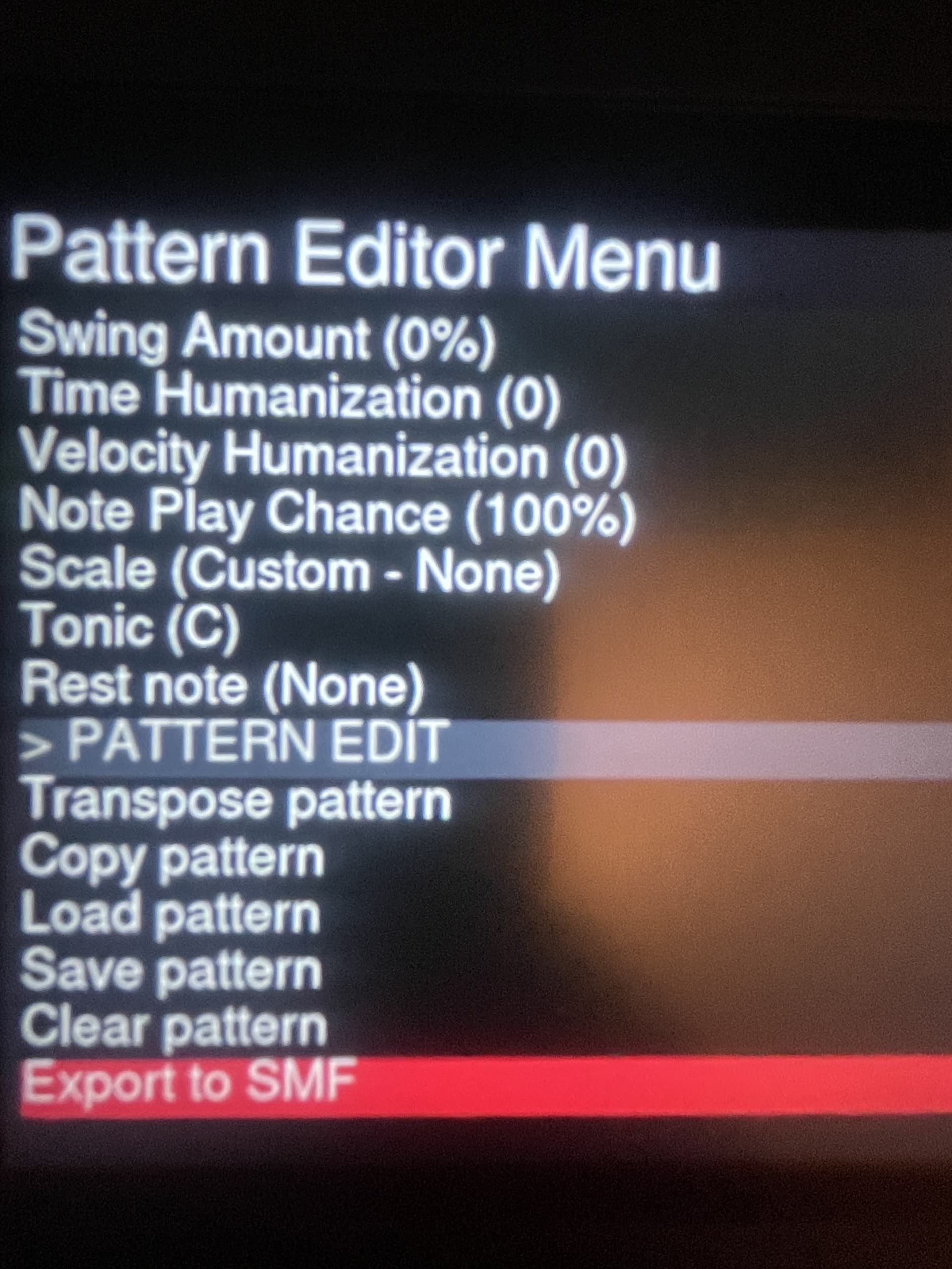

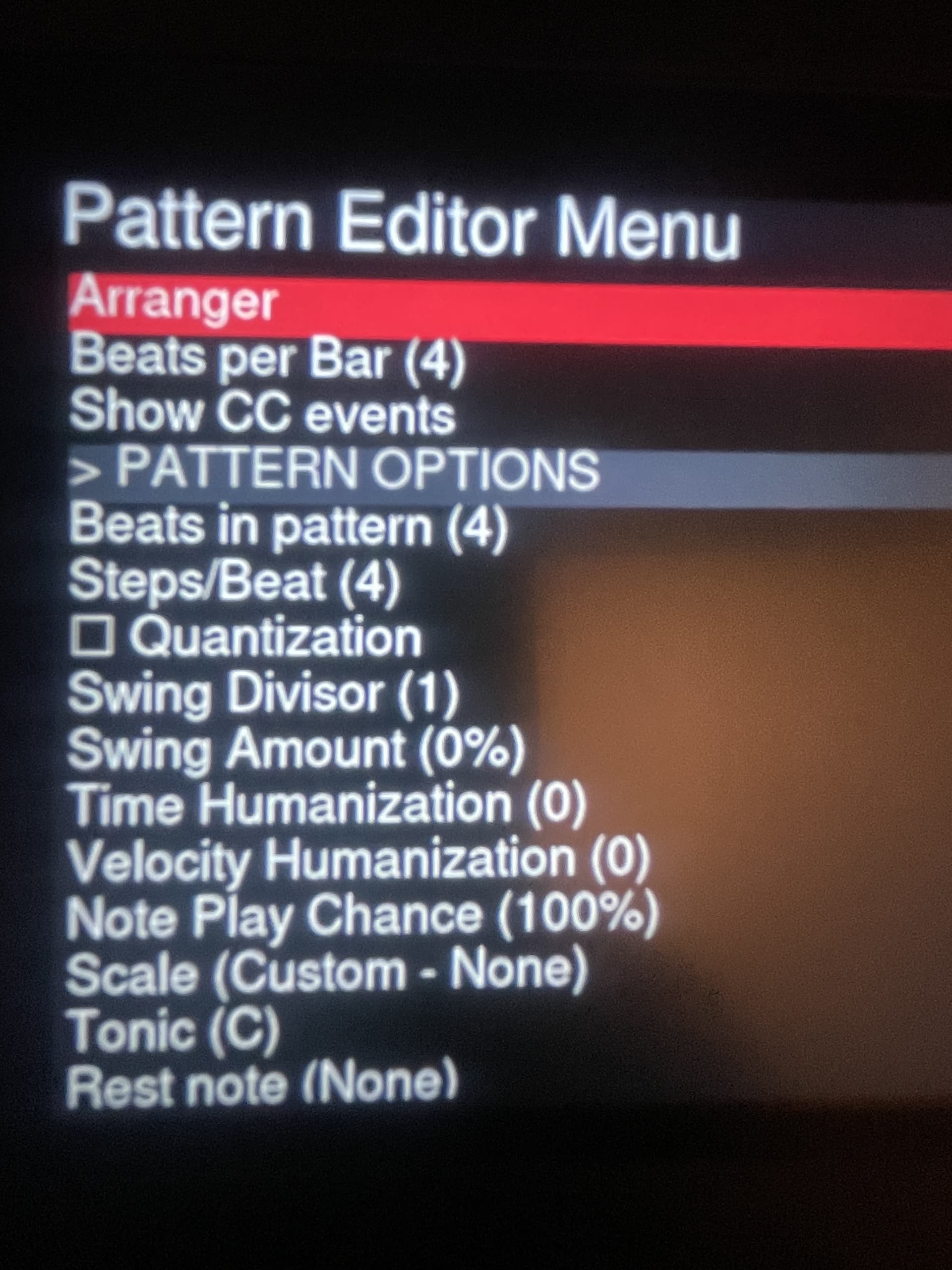

The Adding Notes With External Midi Controller section of the manual states:
Select “Input channel” from Pattern Editor menu to adjust the MIDI channel that ZynSeq listens for input.
but there is no Input Channel setting on my pattern editor menu:
I’m guessing this info is not up to date?
