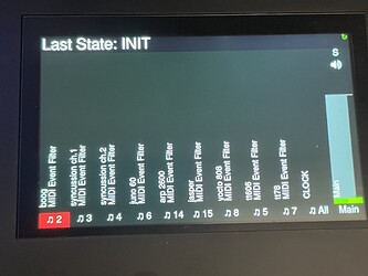

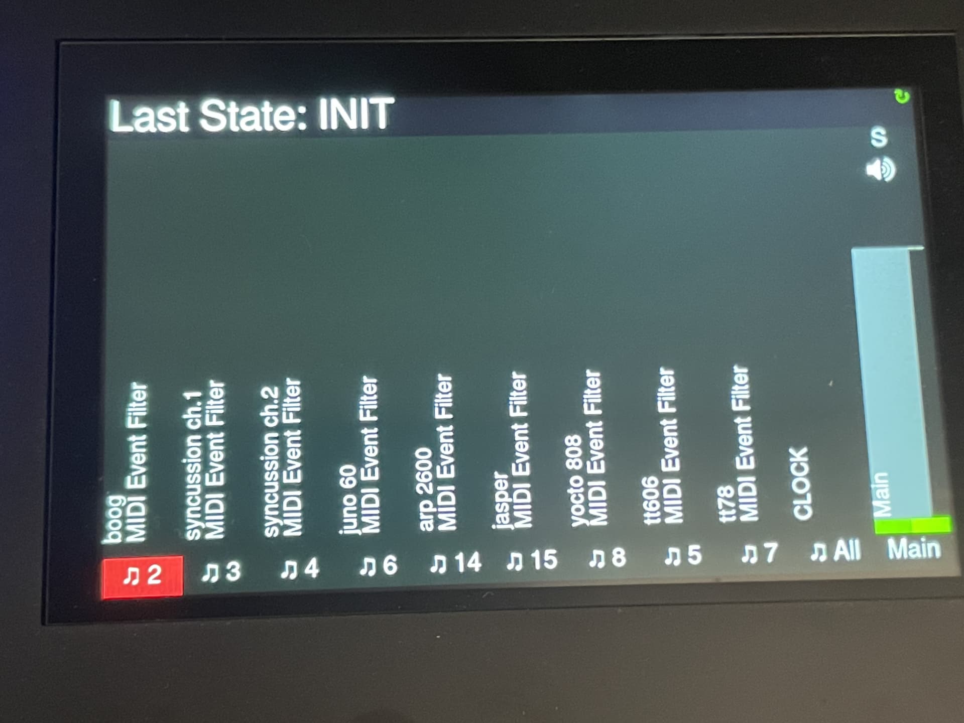

I have 1 track, for clock purposes (see: Using Zynthian 5.1 with external synths, midi chain, clock and transport duplication issues - #8 by rv5 ) that is currently configured to “ALL” channels. Even though it doesn’t need a channel, it’s just for clock.
For some reason, to automagic chain selection prefers that “ALL” chain over chains with specific channel. Even if I put that “ALL” chain at the very end, it will always select that one:
I set it to channel 16 (which is currently unused) and BAM, it works now as it should :slight_smile:
