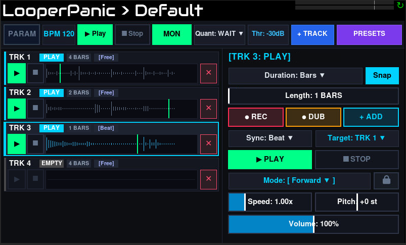

ps: this is a plugin I just developed, it’s a replacement for SooperLooper, since I cannot make it work properly (looped tracks often get stuck and do not respond to clicks and commands).

Hi! Yes SooperLooper is a great, features rich plugin and you did a great job.
I tested it on Oram and I had often problems using it, because looped tracks often got stuck and they did not respond to commands (like mute, pause, reverse, and so on).
At the time I didn’t feel like using it in a live show. So I started developing my own Looper, as an experiment. I like to have all the functions on screen without the need to menu dive or to search for the right parameter to tweak.
Recently I started using Vangelis and maybe now SooperLooper works well, but at the moment I find my looper easier to use, mostly because I don’t have to menu dive.
I’m aware of some things that need to be fixed or improved and there are probably bugs I did not find out yet :sweat_smile:
My main goal now is to explore creative ways to use the touch screen and create good user interfaces with limited menu diving.
Next step, I’ll try to use zynthian knobs to change some params, with knobs hardcoded to these params only (when the ui is fullscreen and the default zynthian params column on the right is hidden).
For instance, I want to use knobs to change duration, speed, pitch and volume of each loop. I don’t know how to do it, yet… but I’ll find it out.
