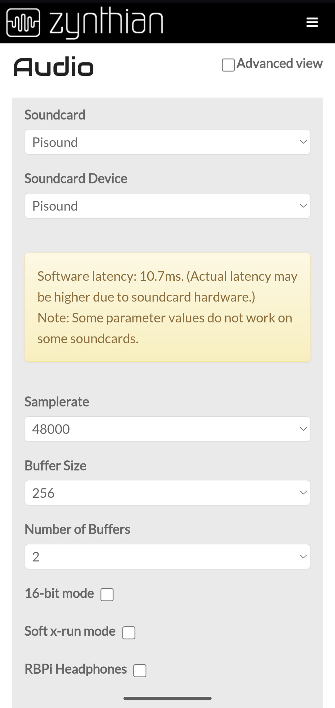

I am using the default settings for pisound:
