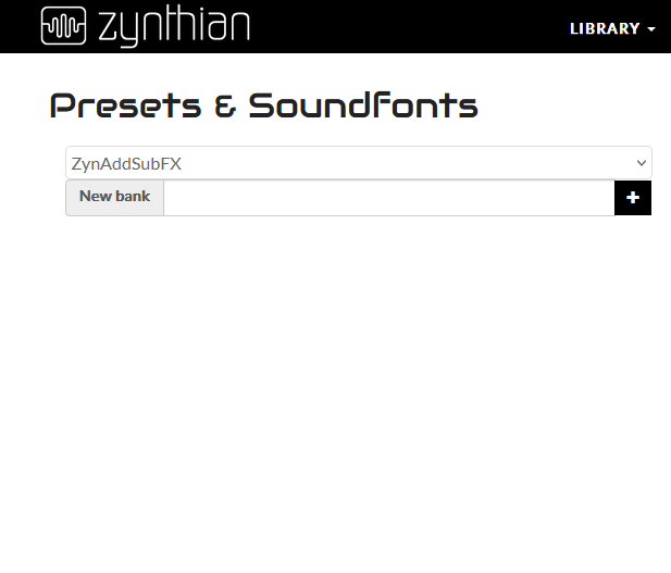

When I plug in a USB stick, presets for engines or soundfonts on SD card are no longer visible in webconf.

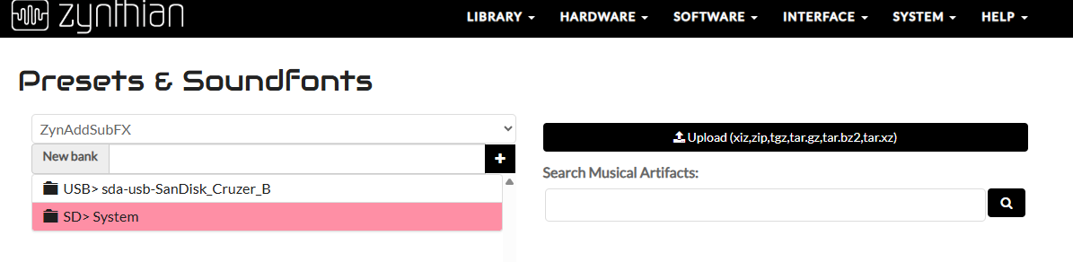

No USB stick:
With USB stick:

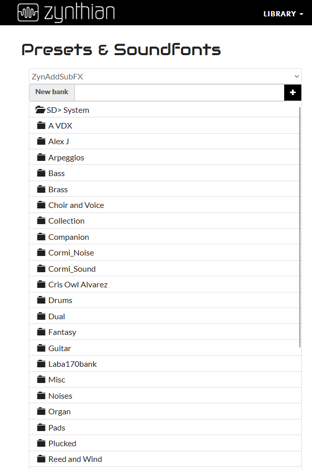

I see both internal and external (in Vangelis):
I wonder if it relates to the browser, e.g. are you using a mobile device, like a phone?
No, Firefox on Windows 11
Is this recently changed in Vangelis?
I see the same (non-faulty) behaviour in Oram and Vangelis.
[Edit] Also, Firefox behaves same as Chrome, i.e. cannot reproduce issue.

Interesting, I changed the USB drive for a VFAT one, that works ok (same as your picture).

EDIT: It’s not the filesystem per se, another USB stick with NTFS works ok. It’s also not the size, another 64GB stick works ok.
But the combination of NTFS and a subdirectory that is not named sfz or SFZ on the drive will cause it to fail. And that also applies to 'System Volume Information', so if you add something on Windows, it wil subsequently fail.
Possibly the same applies to a VFAT drive, but I have not tested that.
If you only have one sfz directory for the soundfonts everything works, even with two USB drives. All other samples must remain in the root directory.
