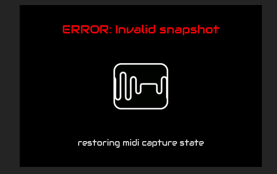

I migrated to the latest version of Zynthian and I’m having an error in some of my snapshots.
I’m adding my snapshot below where the error occurs.
I use several chains at the same time, and in each of them I use the Midi Event plugin to block their midi signal. So I turn them off and on using my impulse controller, but in common I’m having an error in the snapshots that use this technique.

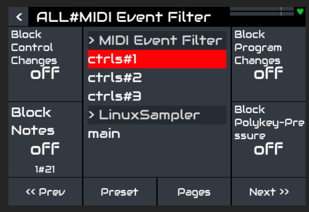

I can reproduce the error by adding a LinuzsSampler chain, adding a MIDI FX (Event Filter), setting a global learn to ‘Block notes’, saving and reopen… it happens every time. As in image bellow

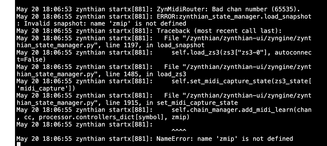

The error Log is:
