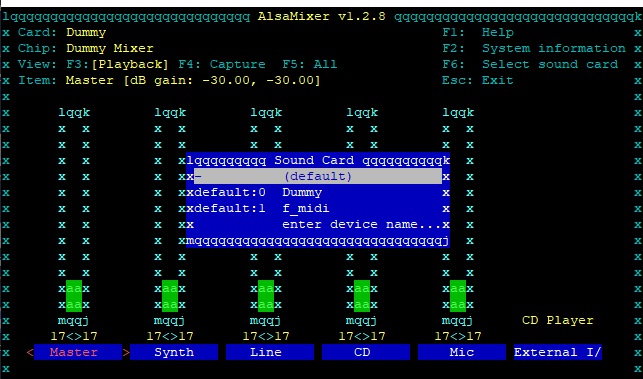

P.S. selecting Dummie sound card on Web Conf… the Zynthian starts up regularly…
It seems like it’s not being seen…

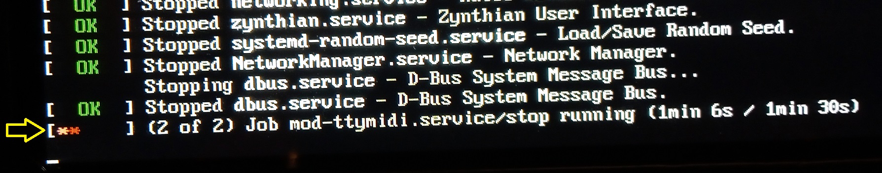

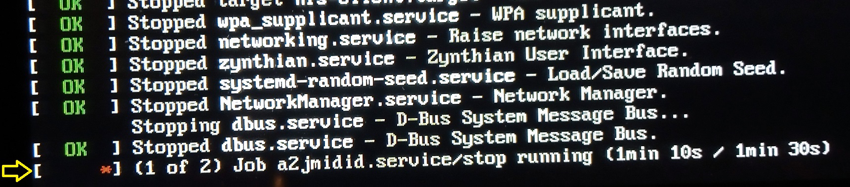

As always, I install Zynthian on two SD cards so I have a backup in case of failure… in the first one everything is fine, in the second one everything is fine but when I turn off the Zynthian it freezes in one spot for at least 2 minutes. Two strings alternate as you can see from the photos below…
Can I do something? or do I have to reinstall again for the third time?

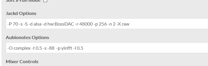

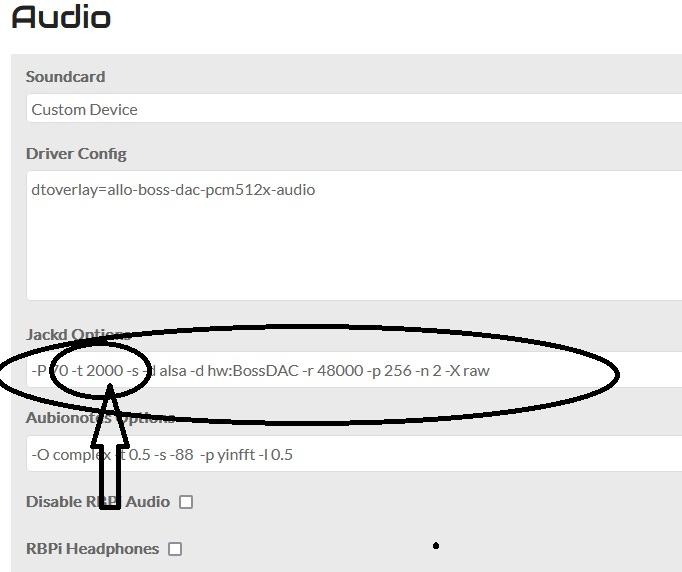

I don’t remember why I added that “t2000”.

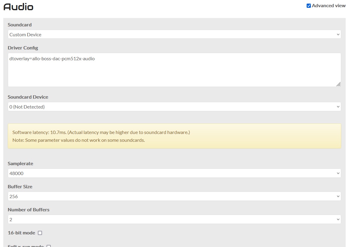

The problem was in the card settings… This is how it works:
This is how it doesn’t:
