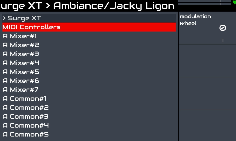

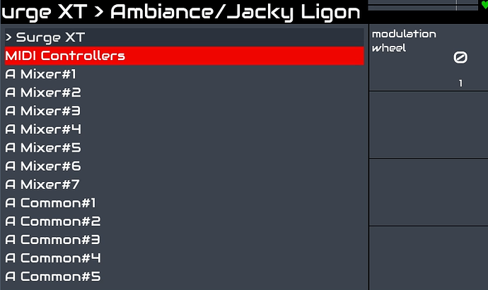

I’ve improved a little bit the group ordering. Please, update and test.
Better, but no cigar.
You have put the B Common settings on top, but the A Commons are still below the LFO settings. Could these go on top please? I don’t know what the B Commons do, but the A Commons set the volume etc.

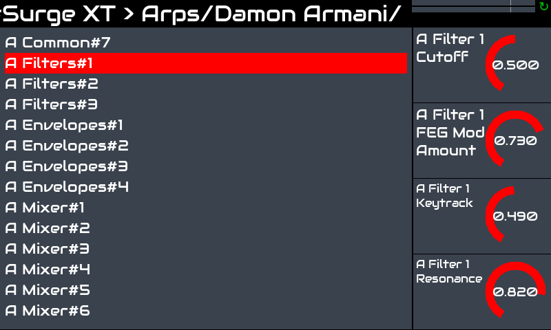

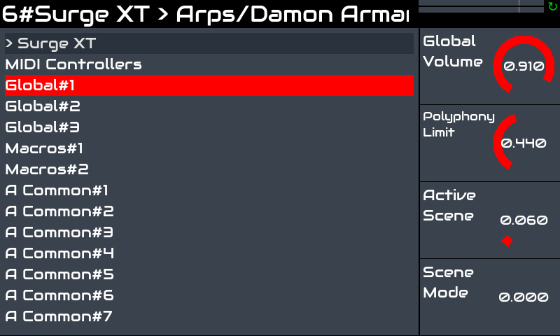

What about this group ordering?
Update and try, please.

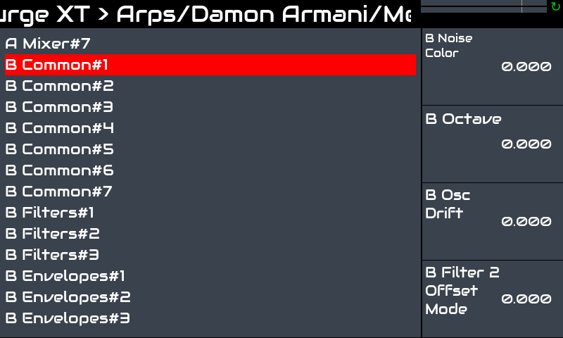

Your order would be great. Mine is a little different, but workable:
The order seems to change every time I reboot. Strange…

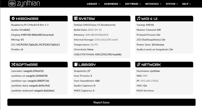

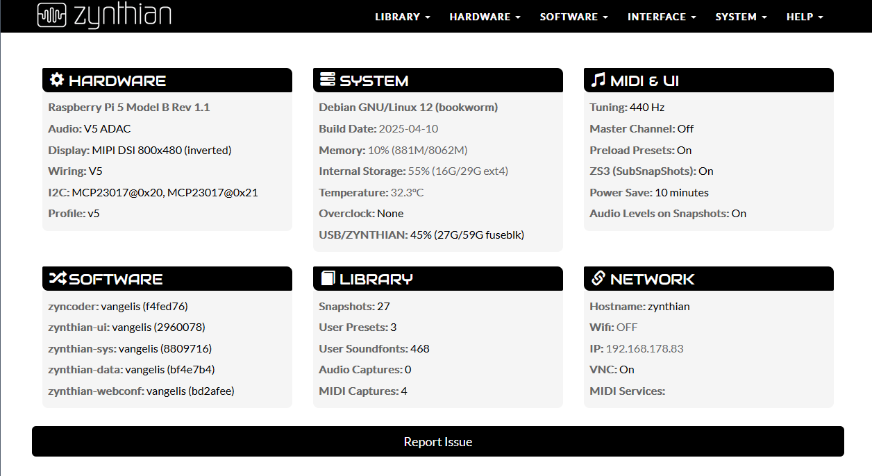

What version are you running? Perhaps you are not running Oram staging or vangelis?
Please, send a screenshot of your webconf dashboard.
You can’t get updates if using a stable tag version. Please, move to Oram Staging or Vangelis.

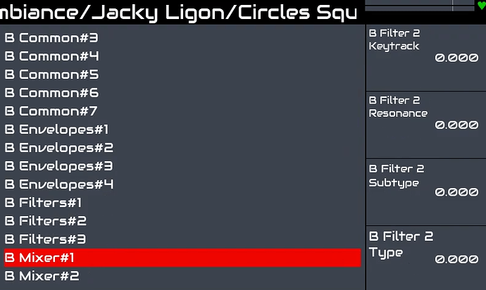

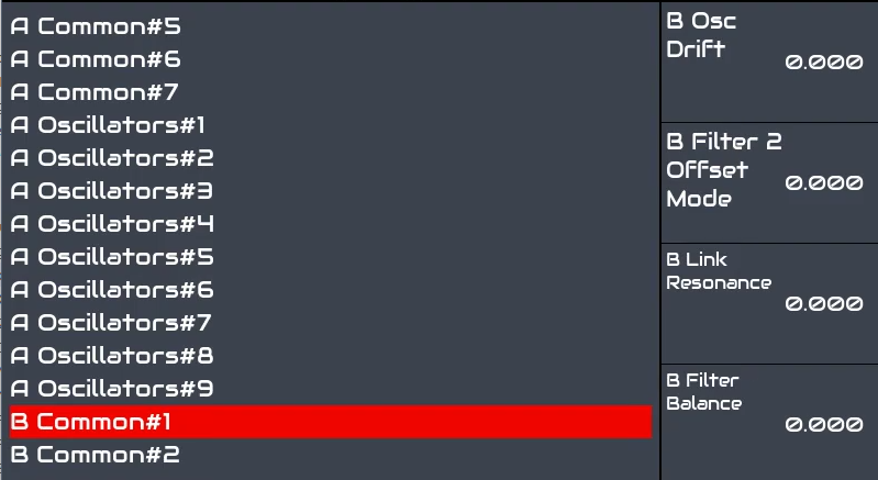

I can confirm that the order of the parameter groups changed on every new instance (prior to this update of course).

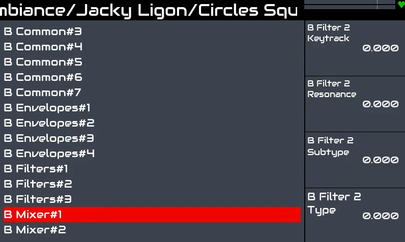

Just moved to Vangelis, updated one moment ago.

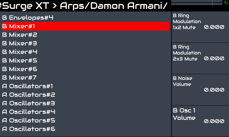

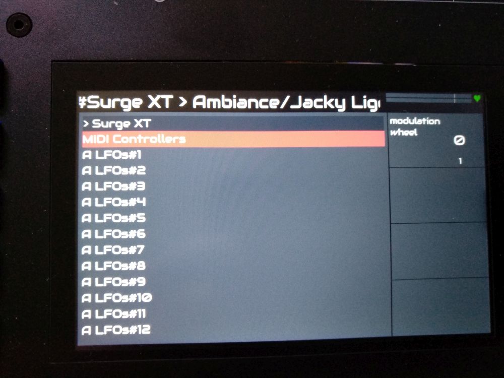

This is even worse than Stable:
(Had to take the camera, Vangelis VNC does not accept opensynth or zynthian as password)
This is really strange. I will take a deeper look in a few days.
