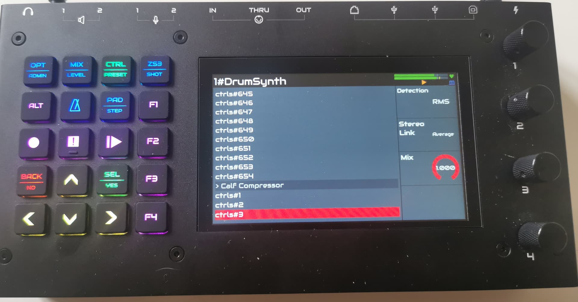

When scrolling ctrl pages, is there another way to scroll than to use the arrow buttons? It can get quite tedious when the pages are too many. Case in point:
Stepping down 654 times pushing down arrow that many times is a bit boring, just to get to the compressor settings :grin:
There, scrolling using one of the encoders would come in handy, for example. A modifier button or something maybe?
Push sel and rotate knob#4.

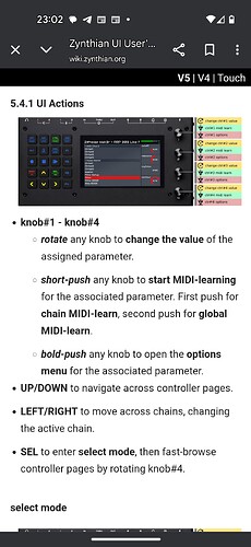

You will find a lot of ā€œtricksā€ like this in the user guide :grimacing:
Thanks a lot! I didn’t know what select mode meant, but now I know :grin:

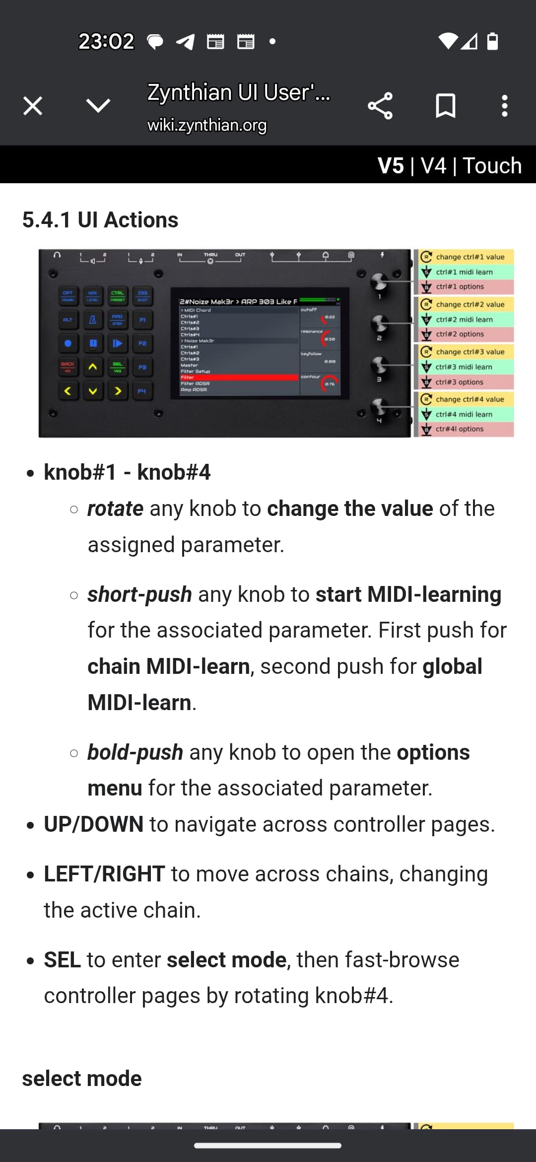

Well, i think the user guide is quite explicit:
  • SEL to enter select mode, then fast-browse controller pages by rotating knob#4.
:grin:
thanks
I’m very sorry, but I swear on my grandmothers grave that I searched like crazy and there were only two matches for select mode on the page I found.
