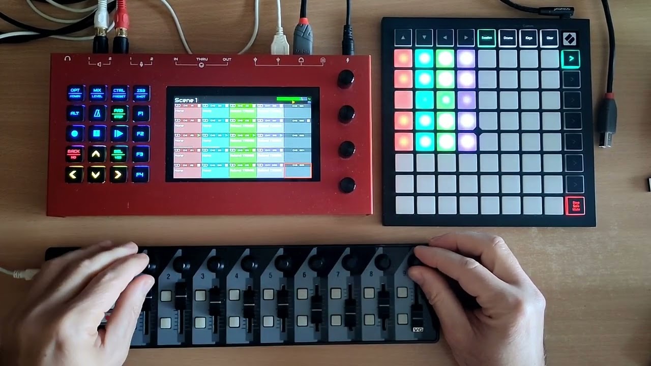

2x JC-303 and FX on Zynthian
707 Drums on Synthstrom Audible Deluge
After installing the JC-303 i had the idea to recreate a Zynthian version of the legendary Rebirth RB 338. I loaded two JC-303, a TR-808 and a TR-909, both Linux Sampler presets. Then i added compression, distorsion, autofilter and delay. I like the result but this is just an experiment because it’s difficult to replicate the original Rebirth system.
Even the track is a work in progress, and it’s not so acid as it should!
The video show the way i use my Lauchpad and a Korg Kontrol wich i mapped with some basic parameter.
If someone would like to improve the RebirthZ (different delays or distorsion and so on…), here is the snapshot without the track.
006-REBIRTHZ.zss (19.6 KB)
