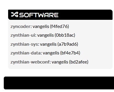

At the moment,It is available only on the Vangelis branch (where the experimen tal feature are integrated).
From zynthian webconf→software→Version, then update, reboot, and should be able to see it.

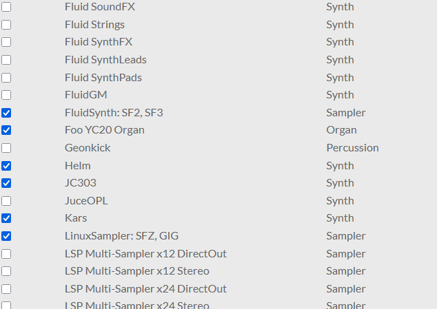

That’s what I did. Don’t see anything…
Did you “Search for Engines” in webconf SOFTWARE:Engines?
