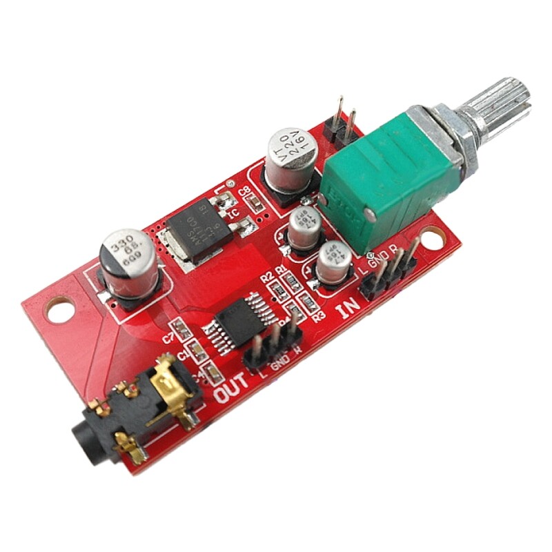

Maybe something like this from our Chinese friends for a few bucks:
Use the 5VDC from P5 on the hifiberry and connect the “OUT” pins to the stereo jack connector. (I used this one in a DIY organ, works great.)
Seems like this also brings a headphone driver, wont a simple voltage divider do the job? I am going to try this…
