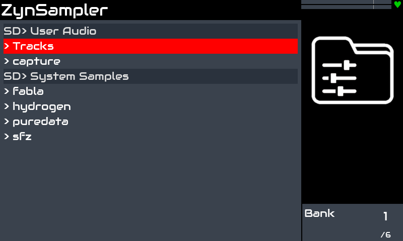

It seems ZynSampler can’t see files in this folder.

It should work. what versión are you using?
zyncoder: vangelis (a03a079)
zynthian-ui: vangelis (da406e8)
zynthian-sys: vangelis (d56ee3e)
zynthian-data: vangelis (1fffd91)
zynthian-webconf: vangelis (af16c55)
If you updated today, the audio folder has been moved to files dir.
not it is clear
the Audio folder is under files: /zynthian/zynthian-my-data/files
Yes. Almost all “user uploaded” files that can be browsed from the UI are under this directory now:
