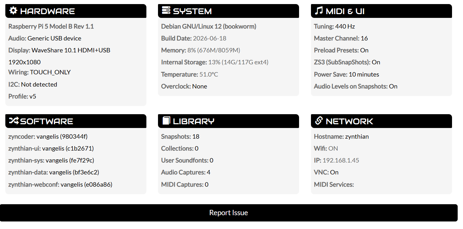

I’m testing the new Vangelis image recently uploaded.
