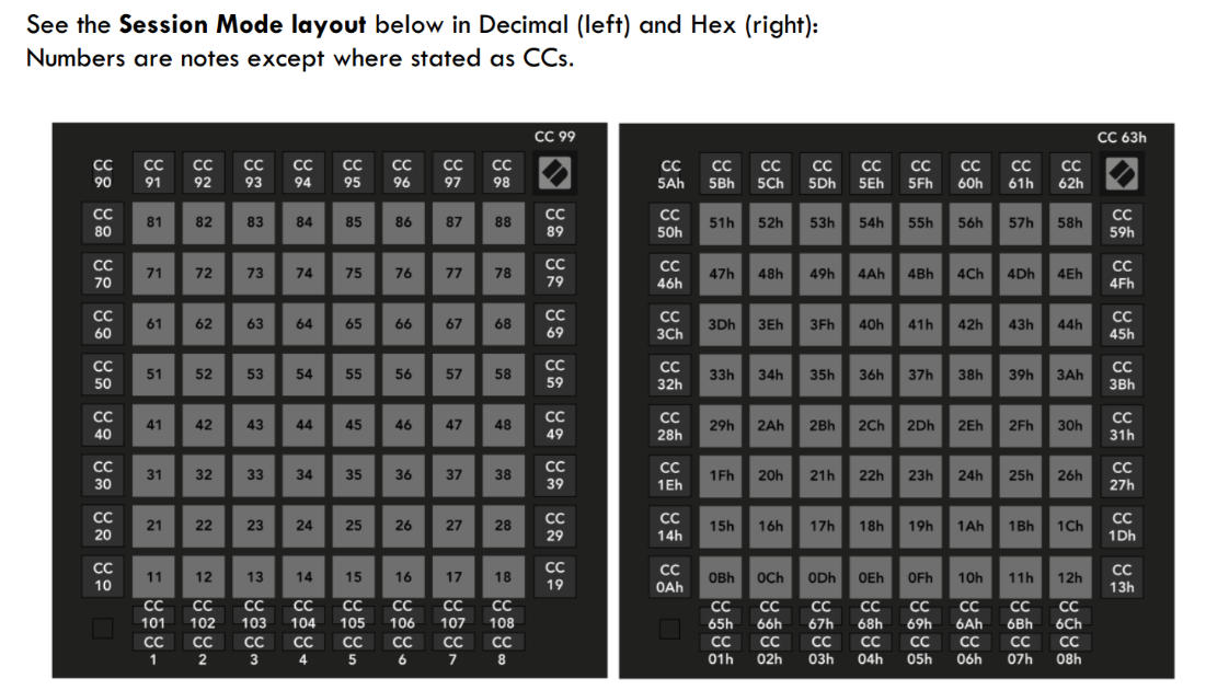

What bothers me is that the release of the button has no CUIA log so I am wondering if the release of a button is an event that can be used in Zynthian
I want to have this behaviour
I have 8 of the thin buttons with these CUIAs

So maybe I am not doing the right thing but look at this piece of code
(ccnum 0x65 is the first of the 16 buttons at the bottom of the LP Pro MK3)
            elif ccnum == 0x65 and ccval == 0x7F:
                self.state_manager.send_cuia("ZYNPOT",[0,1])
            elif ccnum == 0x65 and ccval == 0x00:
                self.state_manager.send_cuia("ZYNPOT",[0,-1])
So with this piece of code I should have the parameter (let’s say Amp Attack) go up when I press the button (7F) and go back down when I release it (00)

On the LaunchPAD pro MK3 I have 16 buttons that can send CCs
So I am thinking of having 4 * 4 sets of buttons
One set will have 2 buttons for emulation of Zynpot Rotating behaviour and 2 buttons for Short and Bold Push.
For emulating Zynpot Rotating behaviour I have a working solution but
self.state_manager.send_cuia(“ZYNPOT”,[0,1])
and
self.state_manager.send_cuia(“ZYNPOT”,[0,-1])
are in some cases very slow if I have to push let’s say 20 times the same button
That is why I was thinking of checking the value of the CC send by the button (127 or 0)
and use it to have only one push to increment (or decrement) parameter when CC value is 127
and stop increment (or decrement) parameter when CC value is 0
Maybe there is a more simple solution ??
Thank You
The 16 thin buttons at the bottom can send CC with value of 127 at push and 0 at release
