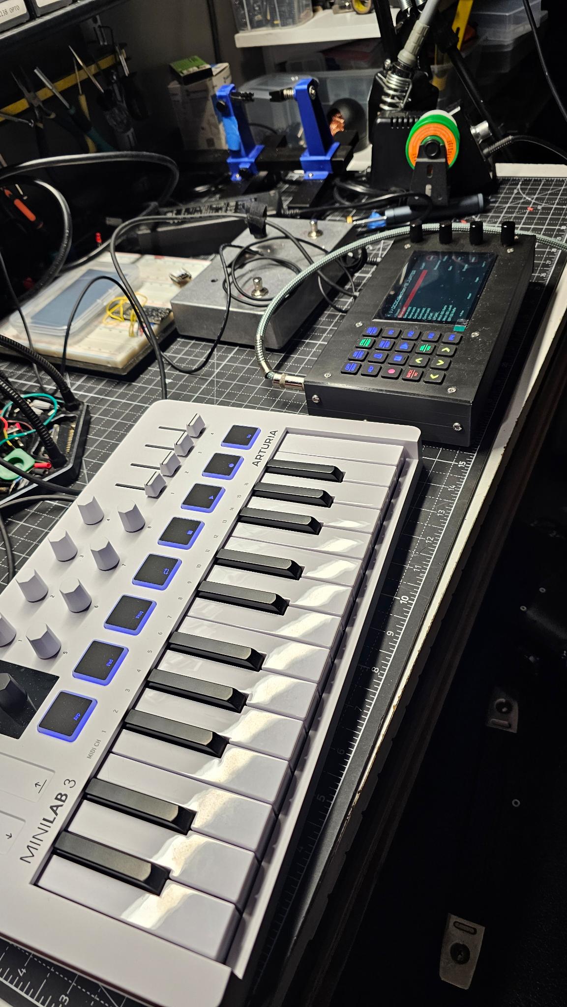

So how does one go about midi live looping with a V5? The Zynth is working great with my Minilab 3. But I’d like to be able to record and loop like this, but with midi and the onboard LV2 plugins: https://www.youtube.com/watch?v=cPl-f9GwNfo
