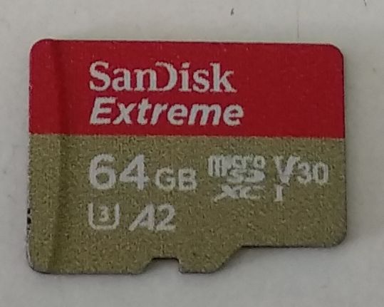

When I use a 64GB SanDisk Extreme SD card in my V5.1 kit I get a number of warnings in the syslog:

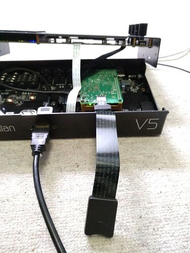

As I have completely disassembled the Zynthian for the removal of the bumps, I can now install an HDMI extension cable (on the front, there is no room elsewhere).
Hans

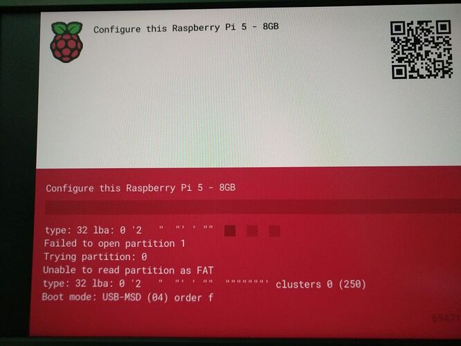

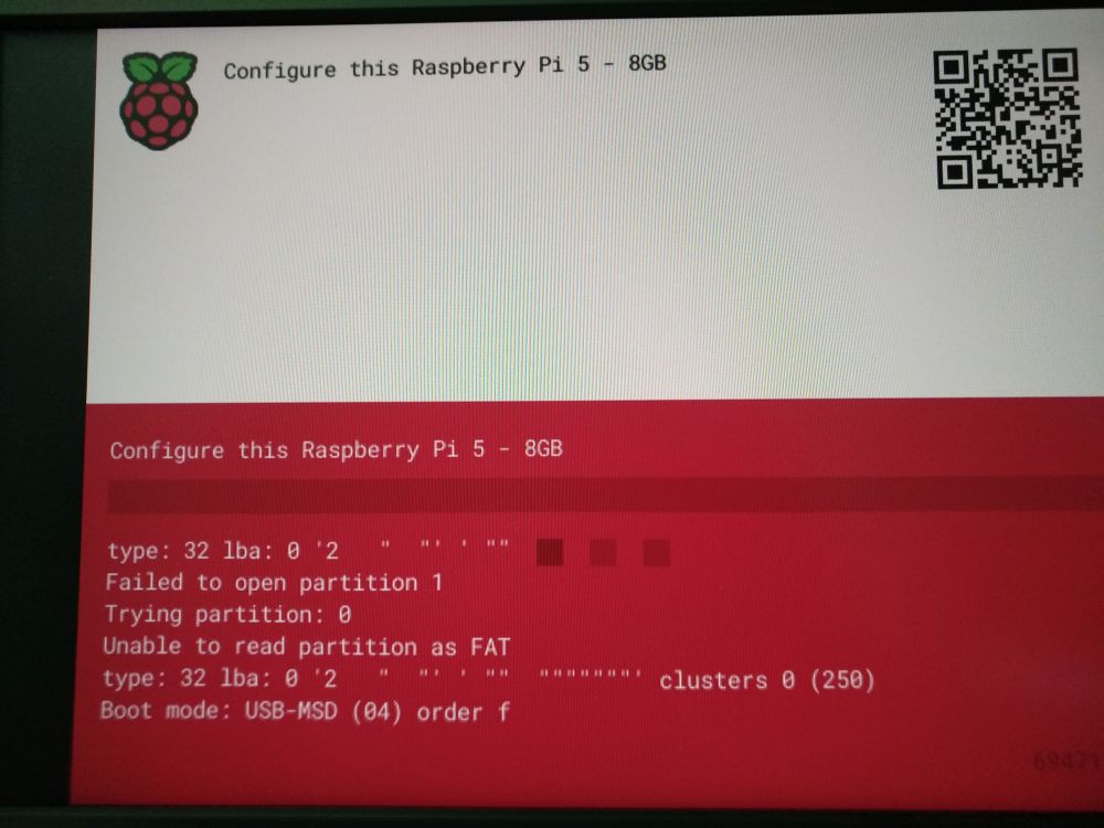

Hi @jofemodo
Bad luck.
After removing all the bumps, the connectors for the control board and USB-C worked fine, but the SD card connector is now dead:
Card directly in the Pi works fine.
Fortunately my new HDMI connector works fine so diagnosing is a lot easier :wink: If anyone is interested I can post some photos.

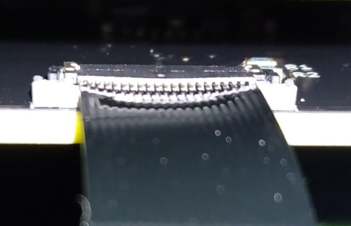

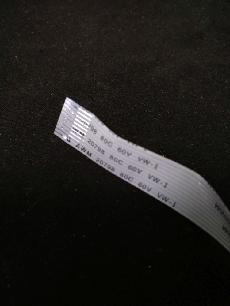

is It the connectors or is t the cable? i mean, did you break the connector? could you send some puctures?
It is the cable. The connector is ok I think (looks ok).
Hans

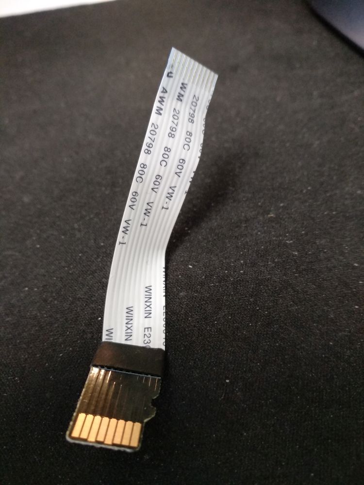

Hi @jofemodo,

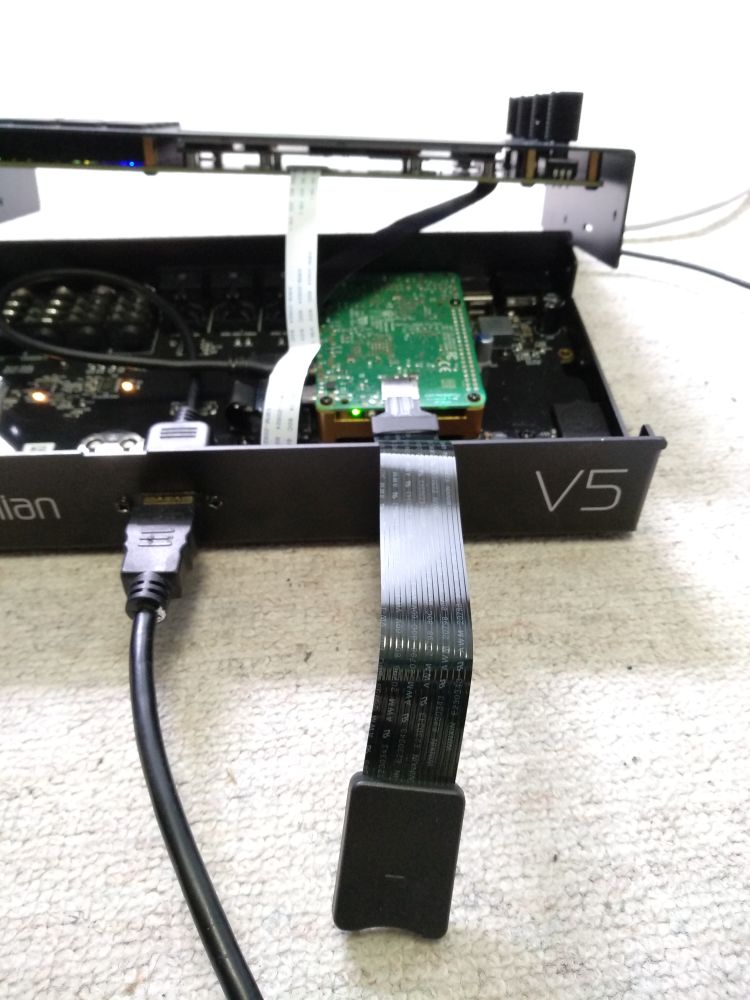

As an experiment I tested the SD card with a different kind of extender:
This works flawless, so these extenders can work in principle with a card in A2 mode.
Of course I’m not letting such an adapter dangle outboard, there are limits :wink:
For my cable I strongly suspect the SD card end to be bad, not the FFC connector end. I would be happy to receive a replacement.
kind regards,
Hans.
