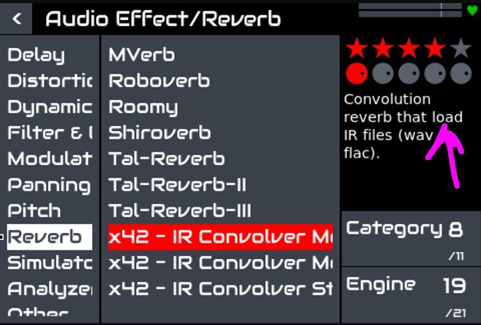

Low hanging fruit - small things to improve Zynthian
Hi
Where can I find the origin of this text, so I can fix it centrally? I didn’t find it on the Zynthian/x42 repos.
I think it’s here (doesn’t help so much to say its on line 1):
Thanks @hannesmenzel!
Pull request sent:
Fix grammar in x42 Convolver reverb descriptions by jawn · Pull Request #220 · zynthian/zynthian-sys
Verified locally by copying the file to /zynthian/config.
As the file is a veryyyyyyyyyyyyy long line it explains why the regular search didn’t find it.
