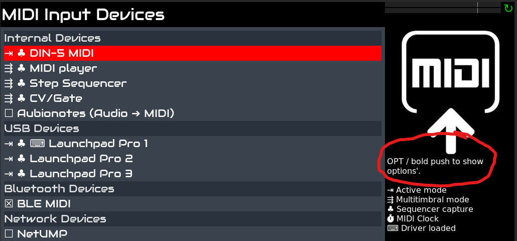

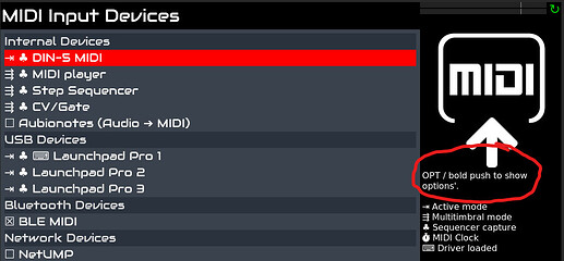

In the midi input devices menu, all the devices require a bold press to access the sub-menu. Is there a logic behind this? I’ve always found it strange why a short press doesn’t go in the sub-menu like most (every?) other menu.
Me too, but never bothered to ask/request. Since there is no competing short action, I think it would be fine to change this.

The MIDI input and output menus are the same menu and reused for admin and chain view. In admin menu they allow services to be enabled with short press. In chain view they allow input and output routing to be toggled with short press.
Merged!
It’s not short press for me though, it says bold press in the tool tip and can confirm it does indeed require bold press:
Only the checkboxes in the menu accept a short press.

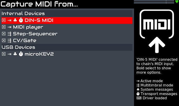

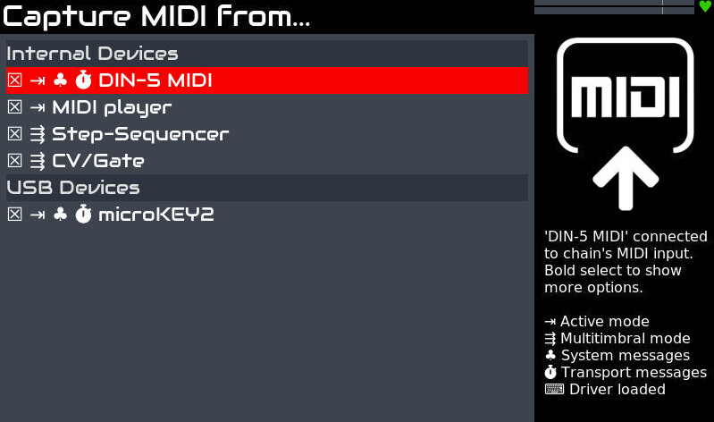

I think @riban means the menu you get when you bold press SEL/YES in the mixer:
In this menu you short press to select/deselect an item and you bold press to change options.
In fact I’m so used to the bold press here that I automatically used that in the admin menu. So no problem for me.
Ok, that’s the logic I was missing.
