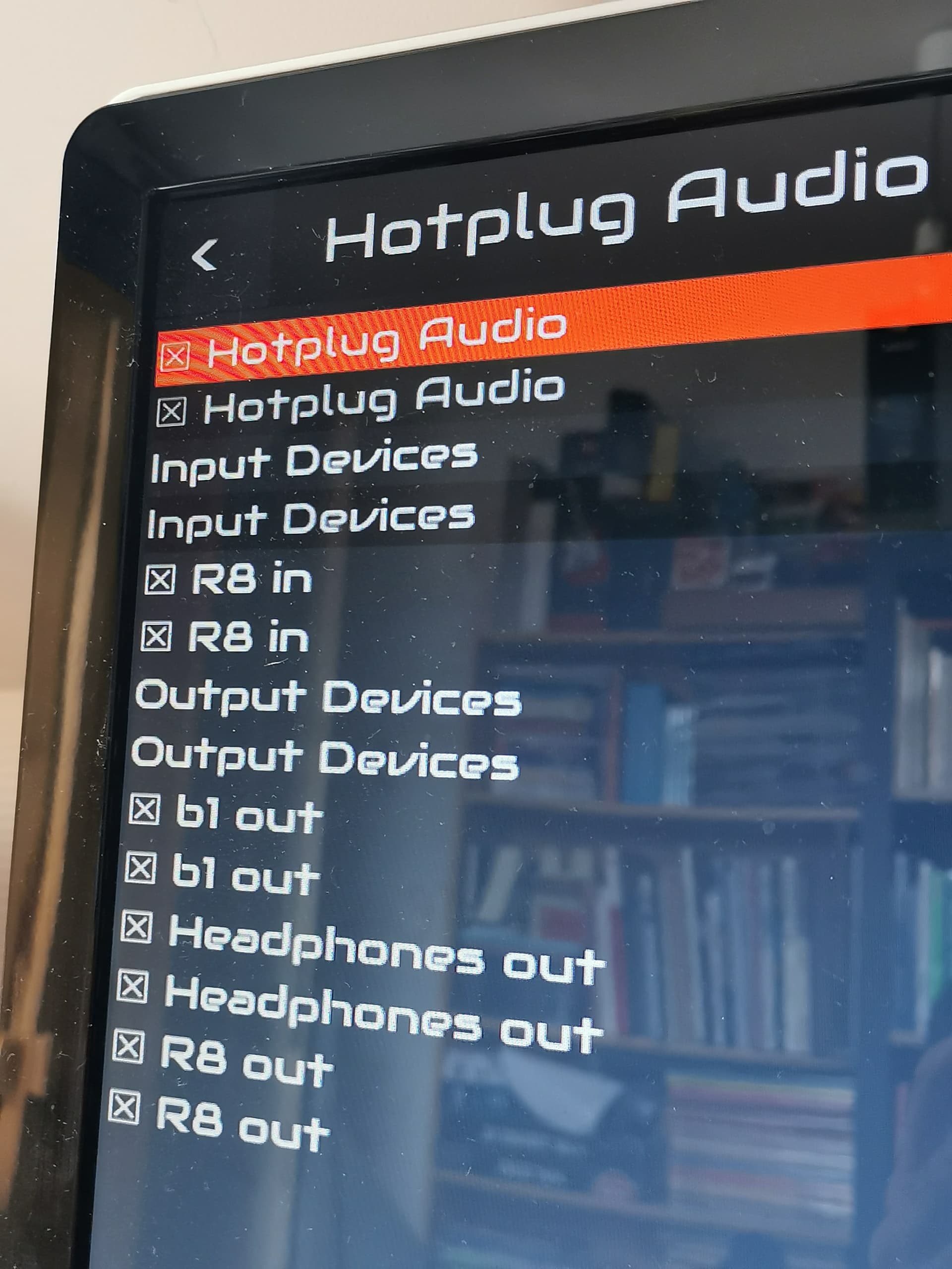

On a side note I’ve seen a bug where disabling/enabling Hot plug audio sometimes adds menu items twice, see here. Should I log a bug or is this a known issue?
Log a bug.
Done Duplicate Hotplug audio menu items · Issue #1434 · zynthian/zynthian-issue-tracking · GitHub
