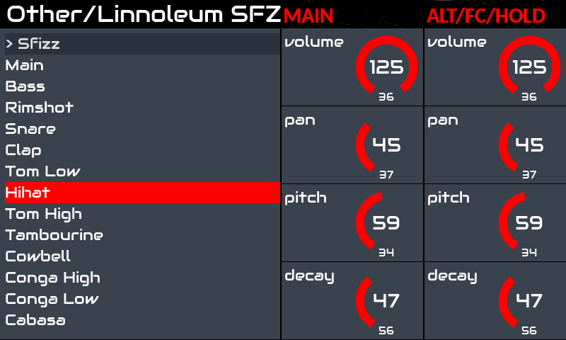

I’m one of those Zynthianers who uses it for sound-design and twisting knobs. Do you think it would ever be an option to have more rows of parameters controlled by the 4 encoders, switched with an ALT knob or foot controller or hold long press?
