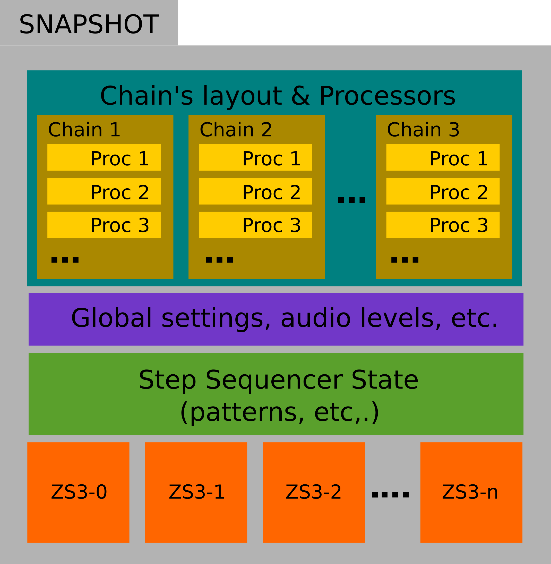

When you say “next preset” or “previous preset” i don’t now what you do mean. In zynthian we manage several concepts that must be understand :
  • snapshots => it’s a file with the full state of zynthian, including full configuration for all chains and processors, subsnapshots (ZS3s) and stepseq state (patterns and so on). Loading a snapshot is slow and could take several seconds depending of the processors to be loaded.
    Snapshot loading can be controlled by CUIA and also using Program Change messages in the Master Channel.
  • subsnapshots (ZS3s) => It’s a partial state in the context of a given snapshot, specially depends of chains layout and processors. ZS3s are designed to be fast to change. When loading a ZS3, no processors are loaded/unloaded. It uses the chains and processors already loaded (snapshot context). ZS3s store processor state, routing config, MIDI learning, etc.
    ZS3s can be loaded with CUIA and also assigned to Program Change numbers (no Master Channel required).
  • presets => Each processor can load/save engine presets. The loaded preset is part of the processor’s state and it’s saved/restored with ZS3s.
