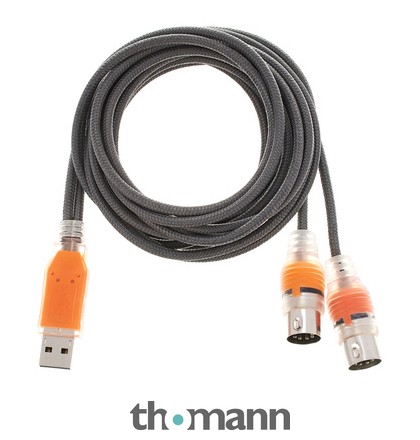

MidiMate is USB MIDI interface anf is possible used it as two output device (I have two and working on raspi)
Maybe it will be an easier way for you
