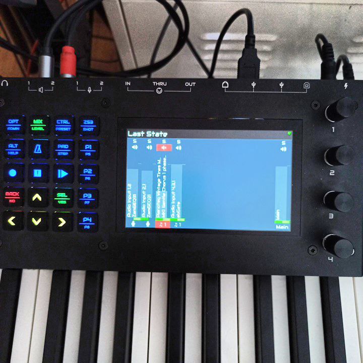

In a set on the mixer with 3 audio inputs (2 mono + 1 stereo) and one piano, I do assign the first 2 mono inputs to a voice –with different settings on each channel– and the third voice (stereo) assign it to a vocoder (for instance TAL VOCODER). Well, the problem is that I am trying to assign a midi pedal to switch ON/OFF the VOCODER on that channel, to work ONLY, when I press the pedal. Until now I have got to make it work reverse mode: id est when I press the sound mutes when not pressing the sound works.

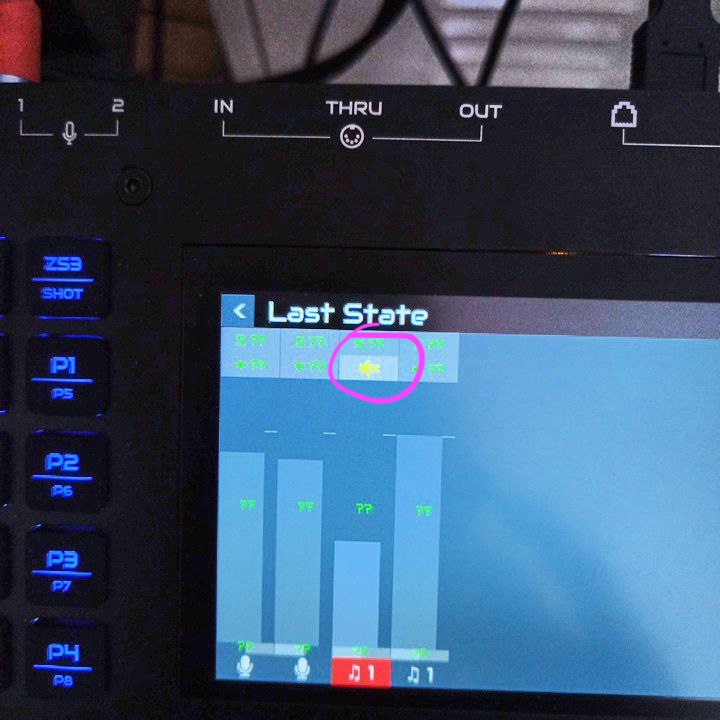

Tweaking the Zynthian controls I discovered a handy way (midi learn options 2) to make that assignment latch or momentary. Momentary is perfect with the only drawback that I have not found a way to make it work in reverse. I am trying with CC6 from the pedal.
Any idea will be highly appreciated, and… if is not implemented this, I am kindly asking for it!
I have attached 2 screenshots to highlight the function I need to change.
