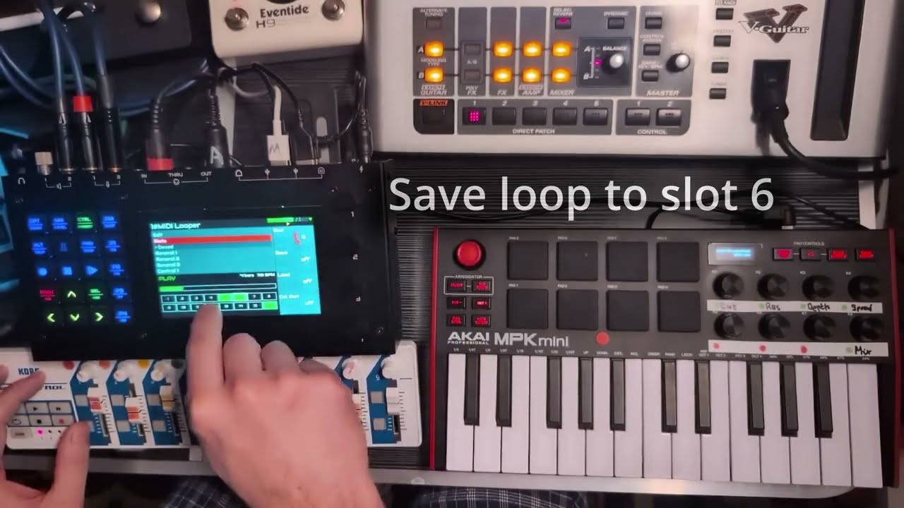

I’ve created a MIDI Looper plugin for Zynthian. It’ll be useful for improvising while composing parts or performing live.
The plugin is placed in the chain before the synthesizer.
You can watch a demonstration of it in the video.
Features:
- Synced to the zynseq transport and tempo; record/launch on beat, bar or loop boundary; free or fixed length 1 to 16 bars
- Rec/Overdub/Play/Stop, up to 8 layers (mute, delete, undo/redo functions)
- CC / pitch bend on a shared lane, with overwrite as you move the knob
- Quantize (1/4 to 1/32, strength, starts/ends/both) on the layers you pick on screen
- Half/Double loop lenth, per-layer transposition
- 16 slots with loops on disk
- Export to a .mid file and into a zynseq pattern
- Touch widget: piano roll with a CC lane, layer colours, slot map
