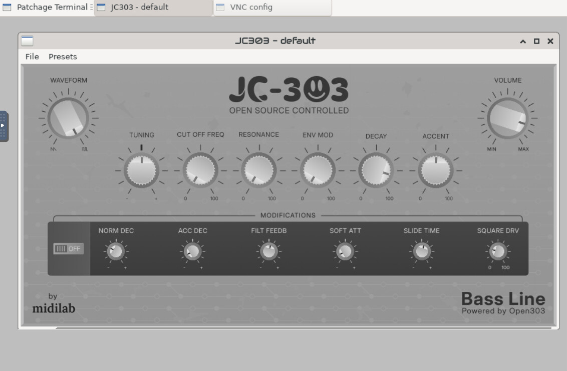

It seems that I can’t find any info how to access this menu in VNC. I can see the screen of the Zynthian menu on my laptop but how do I enable this menu?

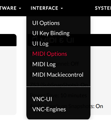

There are 2 VNC views accessed from 2 options in the webconf menu:

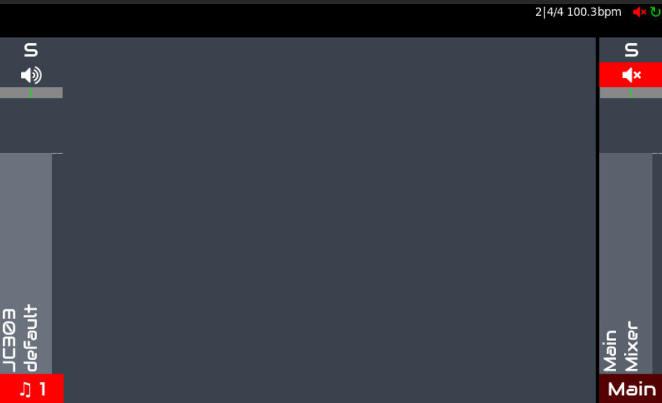

VNC-UI shows the zynthian GUI:
VNC-Engines shows a desktop view with supported engine’s native UI:
On vangelis on my testing/dev setup, vnc-engines is currently broken and therefore unavailable.
On regular ora it’s okay.
I will try and update later today. @funginum which branch are you on?
