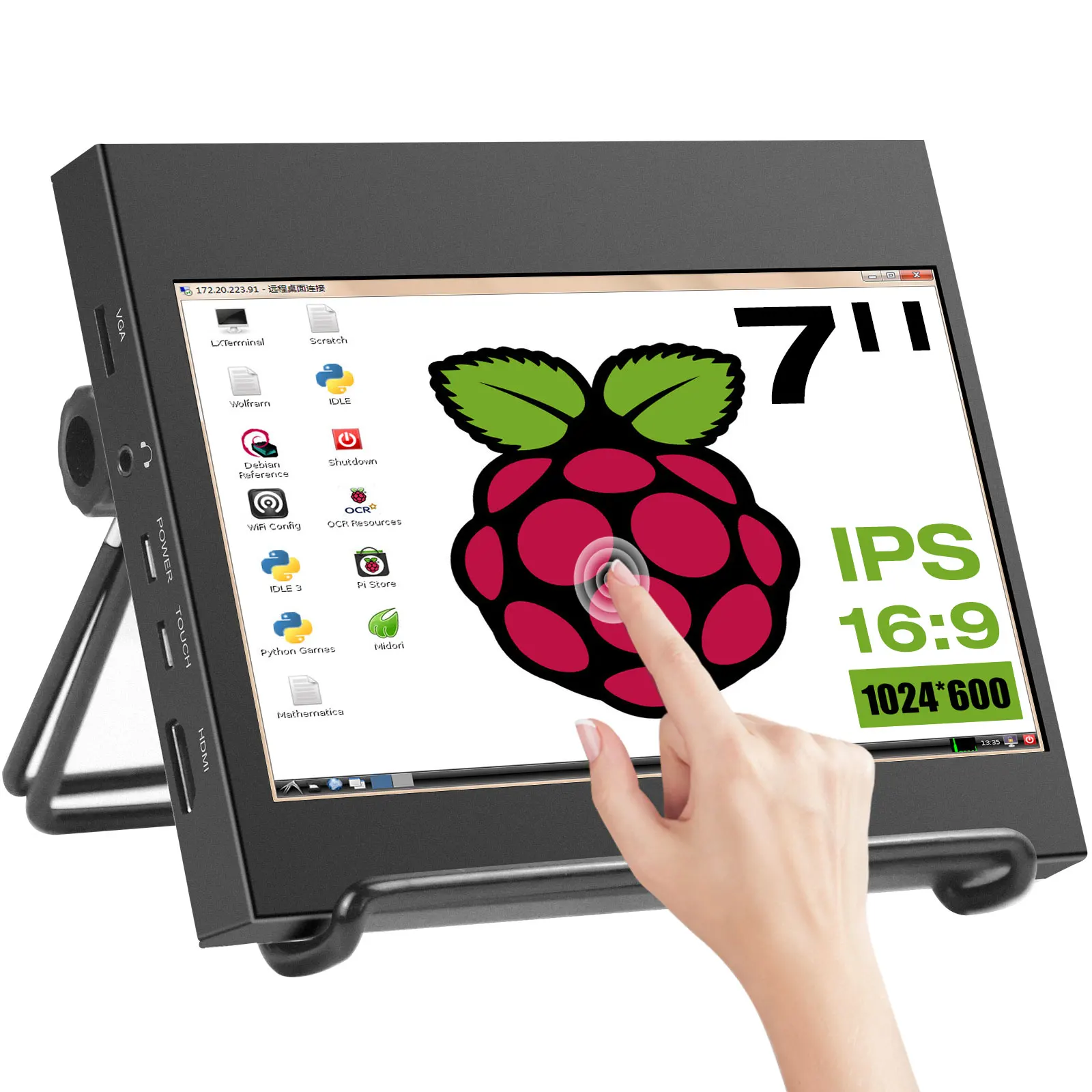

Hello, friends, I bought a 7 inch capacitive screen.
it works perfectly with this version
2023-06-03-zynthianos-stable
However, if I install the other versions I have to disconnect the USB cable and connect it again for the TOUCHSCREEN to work again…
I’ve already tried the most up-to-date versions and it didn’t work, only with this version, 2023-06-03-zynthianos-stable. Is there any extra configuration?
