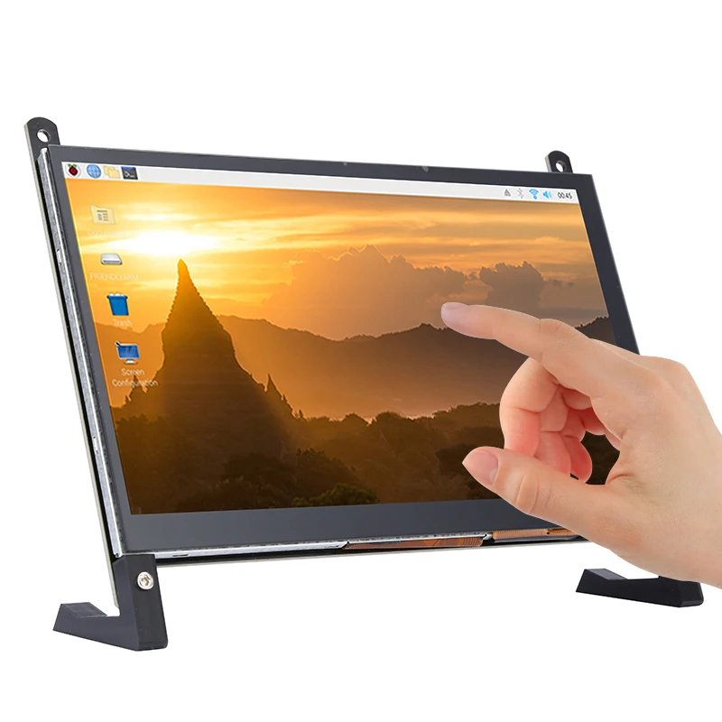

I would like to build a box and wondering what’s the most suitable 7" screen. I see these issues in the thread below about touch problems. I think some of the ones they sell on ebay here are the same model.
I’ve found two types, one with connectors and one with only ribbon cables. Does anyone have experience with the ribbon cable one? Or is it easier to just get the one with connectors on the board?
