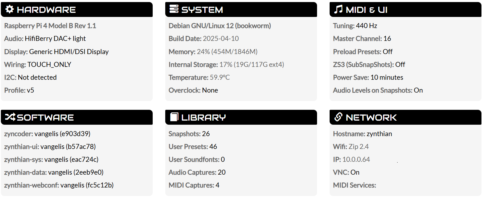

please, ensure zynthian-ui is really updated to the last (Vangelis).
I think so.
OK! I already fixed the issues (hope). Please, update and test.
Working now! I’ll start testing.
