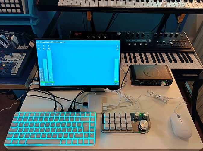

Hi @zynthianers, this is a report on my impressions with running Oram on the latest Raspberry keyboard computer, that is the Pi 500+, equipped with 16 Gb Ram, 256 Gb M.2 internal SSD and a Cherry MX-type LED-backlighted configurable mechanical keyboard.
For anyone interested in trying the same setup, I thought it would have been useful to share some tips and tricks, acquired through a couple of days of troubleshooting and battling, against some initial issues and current limitations, and with some help from AI. This is the current state-of-the-art for this specific Pi-based Zynthian music system.

With the above premises, and considering the small highlighted inconsistencies, my experience so far is that Oram on the Pi500+ is perfectly usable, with brilliant performance and safe (winter’s) operational temperatures at medium overclock, when connected to an inexpensive class-compliant USB Audio+Midi interface (in my case a crisp-sounding Mackie Onyx 2-2) and a few normal peripherals with low energy draw. In conjunction with one of the Romoral (AliExpress) programmable keypad models, configured through UI key-binding on Webconf, this affordable and sleek setup offers a complete synth/audio workstation, with latencies, thanks to the powerful hardware specs of the Pi500+, in the 10 ms range at 48 kHz resolution and 256-sample buffer, fully sustainable even with the more CPU-hungry processors like the emulators.
