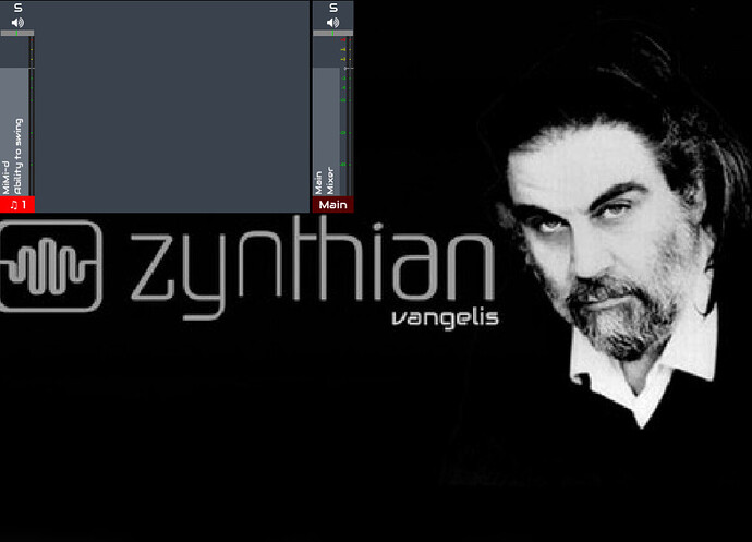

Enabling v3d (dtoverlay=vc4-kms-v3d) on RPi5 seems fine but doing so on RPi4 breaks the UI. There is no output to a V4 screen and VNC shows a large vangelis background image with small UI in top left corner.
Well at least the window management seems to be behaving itself.
