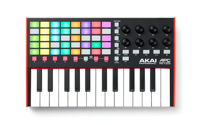

Hi Zynthianers!
I’m proud to say that the driver for the Akai APC Key 25 mk2 is ready! :slightly_smiling_face: :clap: :clap: It has 2 different modes: one which controls Zynmixer/Zynpad, and other to control the UI. With the PAD matrix you will see the available sequences (with different LED brightness whether they are empty or not) and its playing status. You can start a sequence, live record it (also showing the pattern editor), or clear its contents. And of course, everything in RGB color!
I need to create the PR, and also the documentation for those who want to check it out. Stay tuned! :wink:

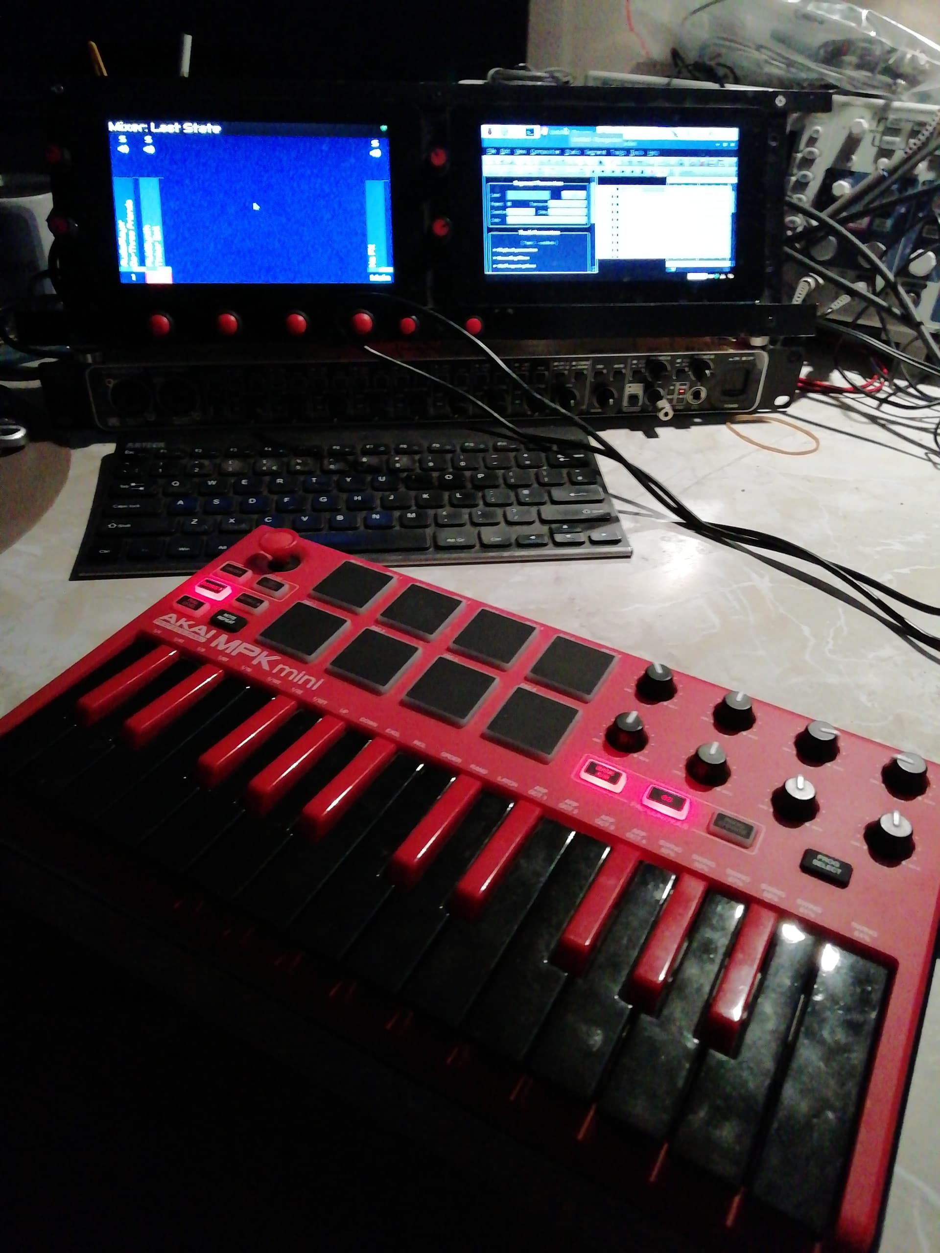

You’ve prompted me to drag out my akai mpk mini which had a non working keyboard, and with a little ribbon cable realignment it now works!
It will be interesting to compare the functionality with your driver.
I also have an Akai MPK mini, there is a working driver already? If not, I might give it a try… :slightly_smiling_face:
To be honest I hadn’t even looked, flushed as I was at returning it from the dead. It predates the Motor 61 as the zynthian controller of choice in various households.
JOFE’s picture shows the MPK mini with the dispaly which appears to be a rather cleverer device all round. Also I don’t run MAC or PC so am rather limited by lack of config software.
