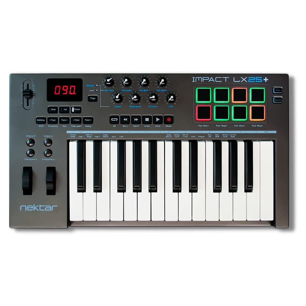

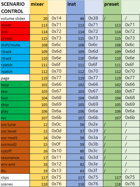

Just in case someone is interested, I’ve just mapped all the Nektar Impact LX25+ controls (MIDI 2)
