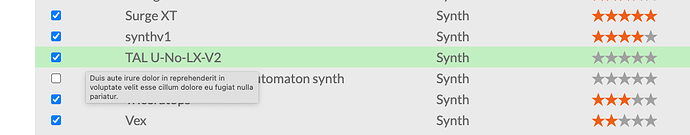

Weird is only that i can’t find the new Tal-U-NO…in the list of synths…
Do i need to run the config tool first ?
