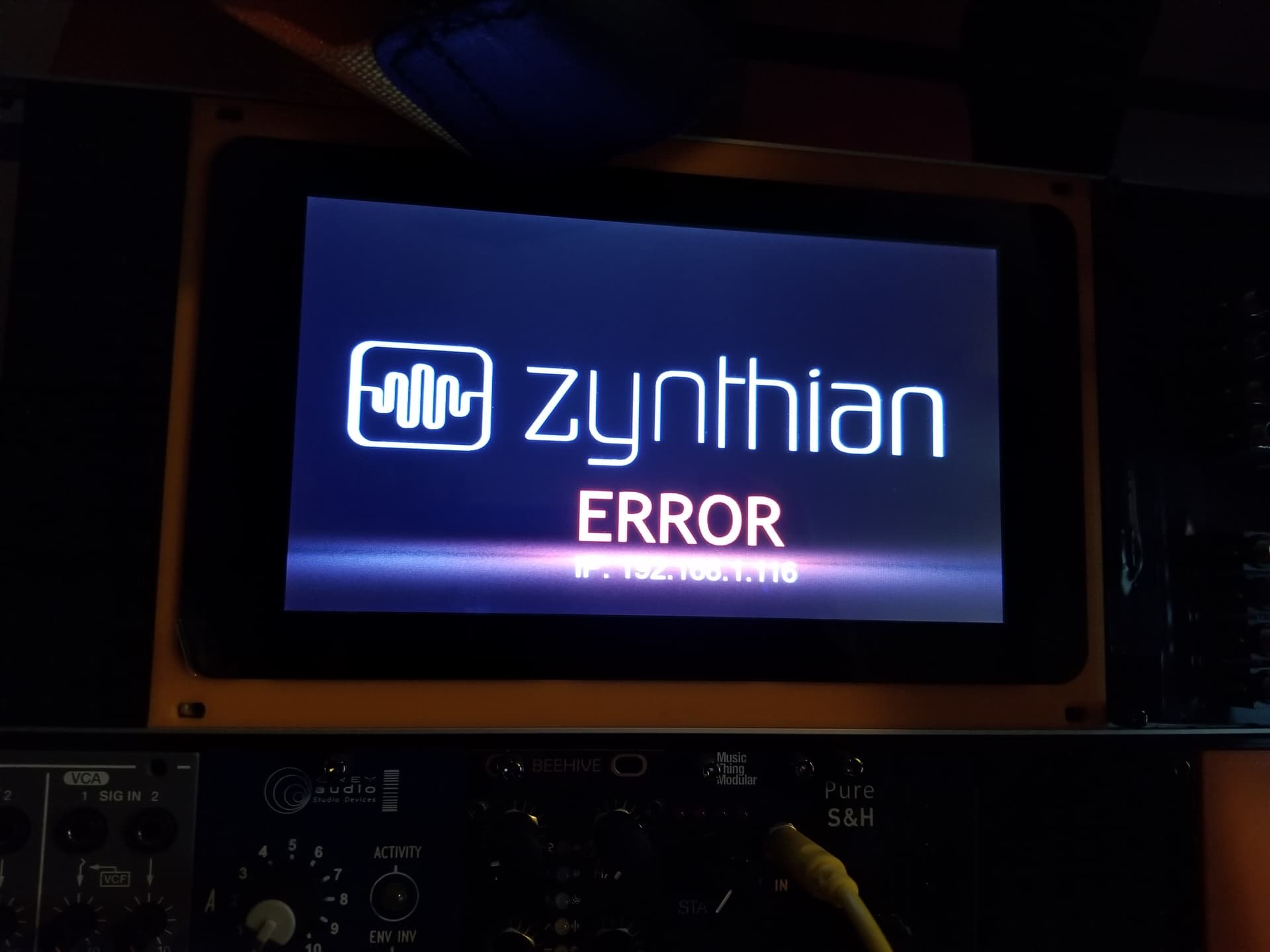

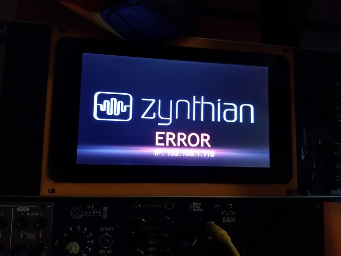

just ran update with repositories set to testing.
after rebooting i get the red error message on the screen and that in the logs. it no worky now!
Simple as above.
Hmmm… I might need a test monkey. I develop on a Zynthian 3 and test on a Zynthian 4. I did the PR from my Zynthian 3. @jofemodo merged the PR then I updated my Zynthian 4 and it worked. It is of course possible that I had done some work on the Z4 at some time that tweaked it to not show this error. I can see it is in the code that handles menus. I will take a look-see.
The issue is with Enable Touch Widgets. I was porting the menu handling code to the base class but that work looks incomplete, not working when touch widgets are enabled. You may disable this to get things working whilst I fix the code to allow it to be re-enabled.

Enable Touch Widgets is now working in Testing.

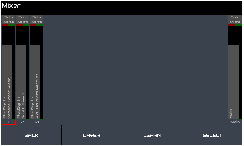

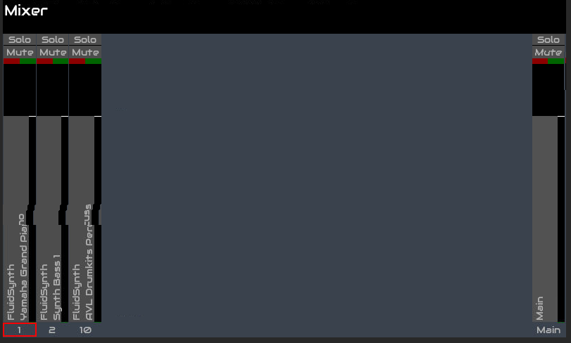

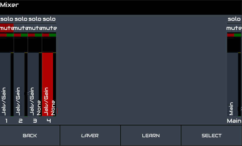

@wyleu has found the menu (which I was going to mention once it was working - I made it work then @jofemodo changed (improved?) behaviour so it continues to be developed). The menu was there to allow access to the core zynthian features like adding engines. The version you are running is flawed in that only the synth engines work. (I fixed that in the development but I may have mentioned that is now void!) The version @MrBroccoli shows is one that changed the behaviour of the channel selection indication. That has subsequently changed in development. We are still working on the development branch so give us a few days to settle things down.
All layers are shown consecutively up to the maximum width, e.g. if your screen can show 4 channels and you have configured 1, 2, 4, 9, 10 &12 then initially channels 1, 2,4 & 9 are shown. Horizontal scrolling will reveal 2, 4, 9 & 10, etc. Missing layers are not displayed, i.e. we don’t show 1, 2, 3, 4, etc. to conserve space. We want as many useful channels to be shown, not a swathe of empty ones. (This has the side effect of moving things around if you insert or remove layers.) The zoom level is dependant on screen resolution. A standard kit will show 8 channel strips and the main mix bus strip.

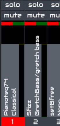

Regarding the red bar… Initially we had a rather (too) subtle border around the channel strip’s index at the bottom of the screen as can be seen by early images in this thread. A modification was done to change the fader to the highlight colour as shown in @MrBroccoli’s image. I worried this was too much (massive bright red fader - warning Will Robinson!!!) and also too little (fader closed = no indication of selected channel) so I propose changing the background of the strip at the bottom behind the channel index like this:
We need something that is obvious on a small screen whilst avoiding interfering with user workflow, e.g. distracting from function.

Perhaps it should include the whole channel column as that is the active area for the press and also defines the object you are currently editing?

Channel selection indication is for non-touch operation which is the prime UI we design for and hence must and will work fully and be as intuitive as we can make it. We also target the 3.5" screen as our primary display as this is the official kit format. The problem with filling the fader strip background is the same as with filling the fader, if the fader is fully open you have no indication of selected channel.
