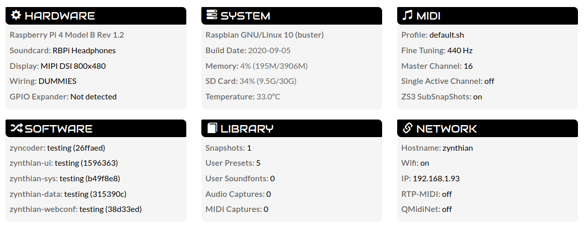

I had a pi with the configuration above: it was last updated the 30th of May.
I did an update through Zynthian’s UI: 158 packages and 120 00 files and folders were updated, and a bunch of software was compiled. And it tooks a while ! :dizzy_face:
But everything went smoothly, that’s great :+1:
