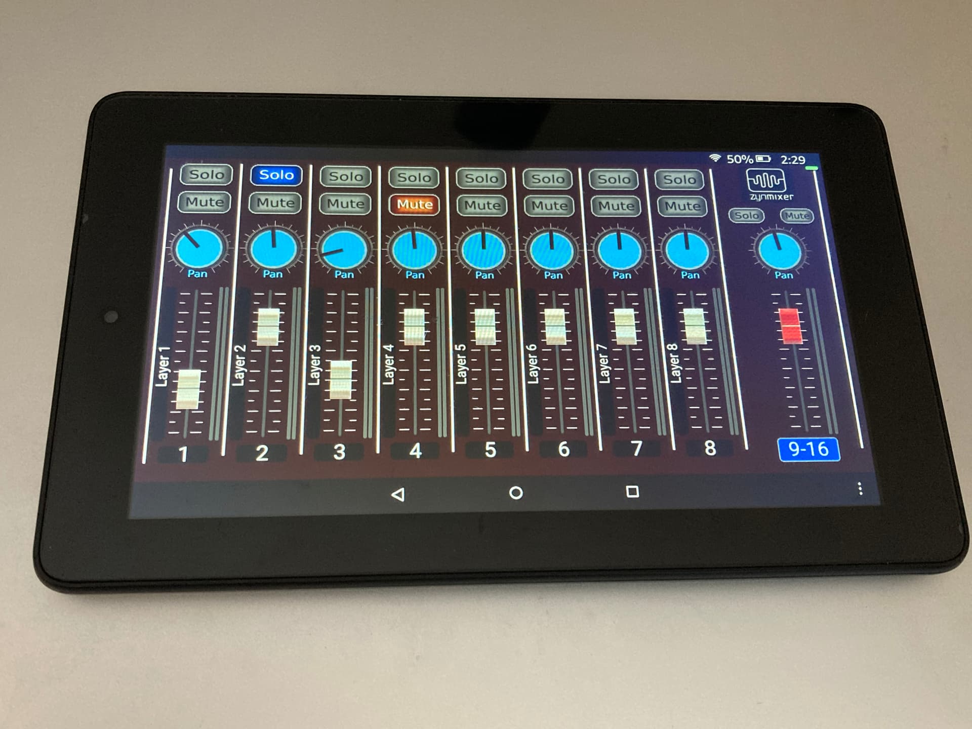

I just changed to the Testing branch and tried out the mixer with DAWOSC. There was some strange behavior with the faders. Moving the faders on the Zynthian would move the DAWOSC faders, but moving the faders in DAWOSC didn’t move the faders on the Zynthian. The solo, mute and pan controls worked fine in both directions. I need to go back and take a look at the DAWOSC mixer layer to see if the faders are setup correctly. For those who haven’t seen the mixer layout on DAWOSC, here’s what it looks like:

oh wow… this makes me to immediately want the zynmixer itself to be 8 lanes wide with funky dials and sliders. i know why it isn’t, i see the logic, but then i saw this.
The native Zynthian GUI shows a different quantity of mixer channel strips depending on screen resolution. On a standard unit you should see 8 channels plus main mix.

Updated and then tested with DAWOSC. The faders are working correctly now.
