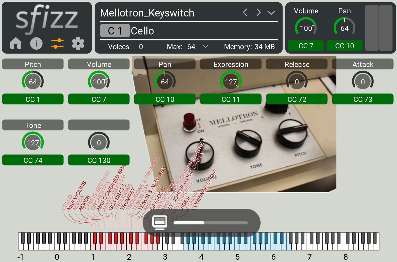

  • “Mellotron_Keyswitch.sfz”: Key-switch from notes C1 to A#2. Sorted in groups, exactly like on the Leisureland website. When opened in Sfizz, it shows a background image which points the right instruments to the right notes.
  • “Mellotron_CCswitch.sfz”: Uses CC2 in the range 0 to 22 for selecting instruments. This is for people with a smaller keyboard.
    I’ve chosen CC2, which is normally breath control, because this control is available on the Zynthian and people can use the internal controls.
    When opened in Sfizz, it shows a background image which points the right instruments to the right CC range.

I’ve made a yml file to test with the “Mellotron_Keyswitch.sfz”.
If someone who has the testing branch could see if this works, that would be lovely!
I think you just need to add the files in the folder with all the sfz’s.
Mellotron_Keyswitch.yml (869 Bytes)
common.yml (325 Bytes)
Hi, I tested it, and it doens’t work in your version, but if you simply delete the ’ in ‘St. John’s Wood Organ’ it does, since that’s crucial for the parser to see where the string is ending.
Mellotron_Keyswitch.yml (868 Bytes)
I did look into the sfz did delete some redundancies in the keyswitch file. It might be easier to edit this way. Also attack and release now works for me, and your polyphonic AT things do work on channel AT as well. And I tried a continuous looping, but you can revert easily if you want. And its 1000 instead of 10000 lines but it’s literally the same.
Mellotron_Keyswitch.sfz (44.0 KB)
personally I would (and will) shorten the attack and release timings on respective CCs. I would maybe also move the pich modulation to the pitchwheel, because on mod wheel it’s quite complicated to get back to normal pitch.
Hey, thanks for helping me out! The SFZ’s indeed where a hot mess. I’ve followed you advise and changed the attack & release timing to 1 second. I’ve also added your looping lines as an optional thing. Hope you don’t mind?
I thought about pitch modulation on the pitch-wheel but you have to hold it so that was a no-go for me. On my keyboard the mod-wheel has a notch in the middle, yours not? If not, I’ll put it on another CC.
