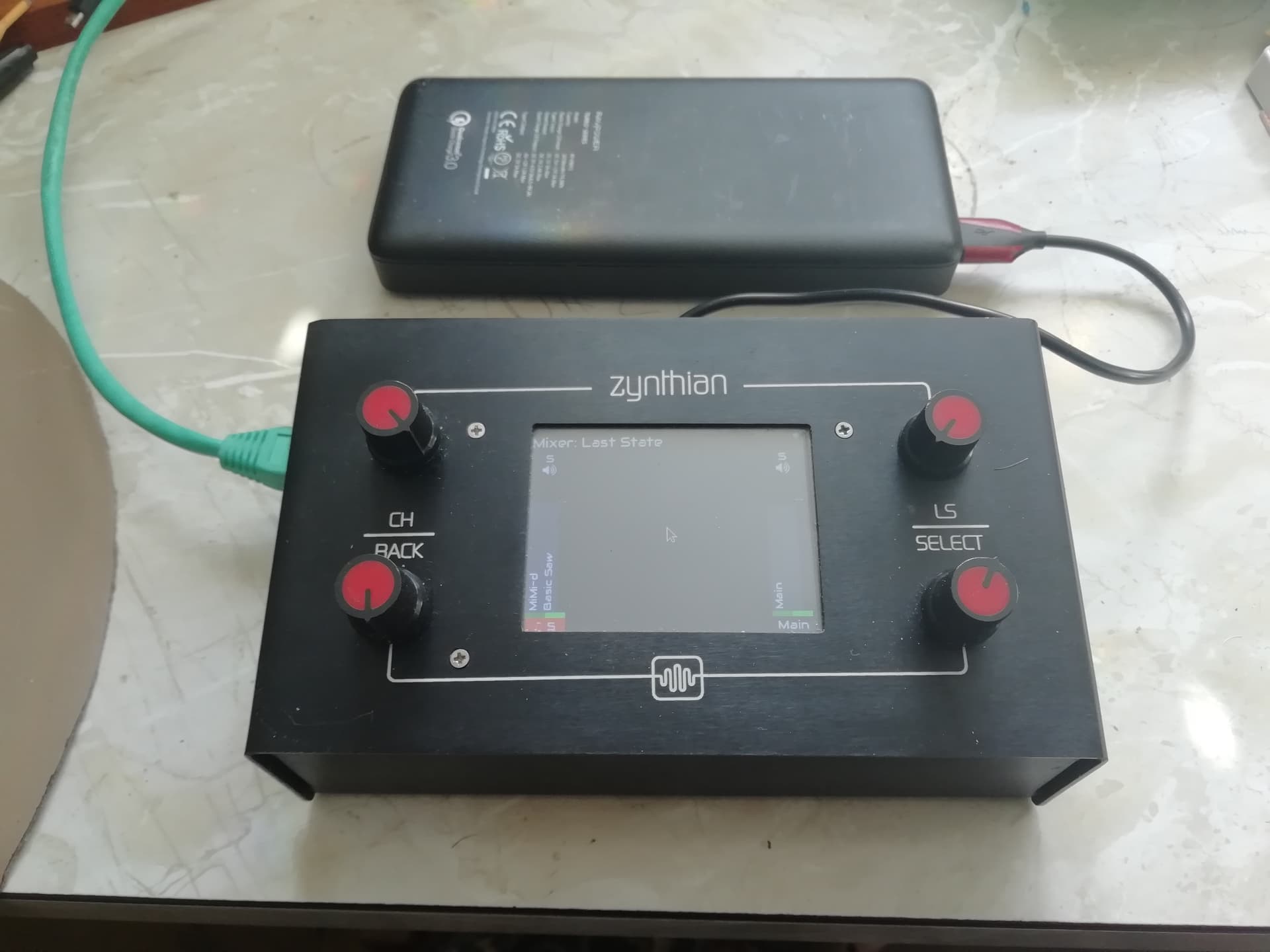

A problem the zynth had way back in ancient history. You had to take a Version One apart to change the SSD… Incidentally
this Version one is running oram from a battery pack…

What a beautiful picture! I love to see this venerable V1 running the latest Oram image!
