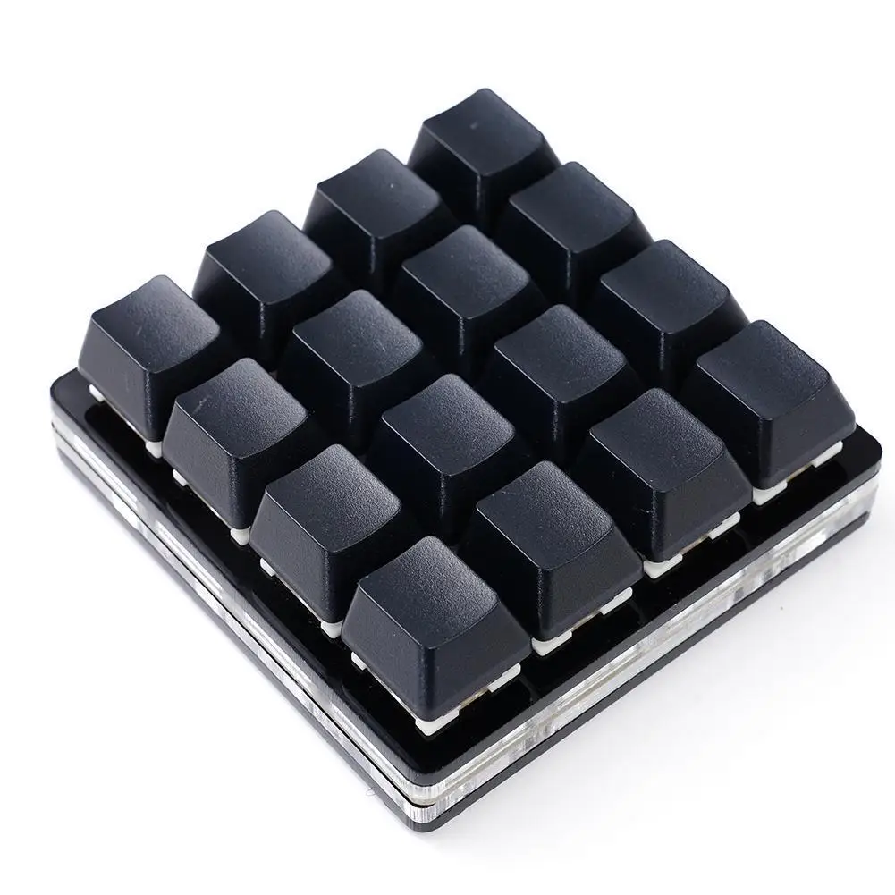

IMO v5 buttons are necessary and even their implementation as onscreen buttons recommended by @wanthalf are big improvement to what currently is available in oram. Buttons provide quick access to important screens that otherwise would need several touches with current Oram implementation. Also without encoders and arrow buttons it is very difficult to navigate by touching options from menu’s.
Another way of improving easily user interface is by buying usb 4x4 keyboard.
They are tenner on AliExpress and work great. Still encoders are required but they can be plugged directly to rpi pins. I tested one last week and they are great.
I know that v5 is 4x5 keyboard but that configuration is so rare to find on AliExpress. 4x6 is more available but it is almost twice the price of 4x4 which I believe is enough.
Here is the current keyboard layout that I tested with 4x4 keyboard that works great.
I also ordered keyboard plastic stickers to be printed like this to see how will they look on this black keyboard.
Alt button is not really alt button that is on v5. It is used to trigger all alternative (bottom labels) as well as to control midi recording instead of audio recording. It needs to be pressed together with another key. This is because this is a keyboard and there is no long presses that you can use as with v5 keyboard which are push buttons. I found no difference in doing so and even more intuitive. Top label is normal action, while bottom label is triggered when alt key is pressed together. Finally, arrows can be used with alt key and to have the same as f1-f4 function. Hence no need for 4x5 keyboard.

You can bind HID key press to V4 or V5 zynswitch events then they will give short, bold & long press triggers.
An alternative keypad is a standard USB number pad which are available wireless from Amazon for abut £8.
The latest touch UI gives fast, usually single press access to many of the most frequently accessed performance screens, e.g. mixer, zynpad, ZS3, control. I’m not disregarding the advantage of dedicated buttons but am interested in specific feedback on how the latest touch UI works. Specific criticism with example workflow will help to shape it. I am currently quite pleased with how you can access everything quickly with touch.
Hm, clearly I don’t know how to use it. For example, when I am on mixer screen I need to bold press encoder 4 to open menu and then, using encoder or touch to select sequencer or snapshot option in the menu. I need to investigate how to do a single press.
I don’t know how to configure HID events so I recommended programmable keyboard. Without HID events where we can sense long presses we need alt or control or shift key to be able to trigger alternative key functions. I will investigate this further.
