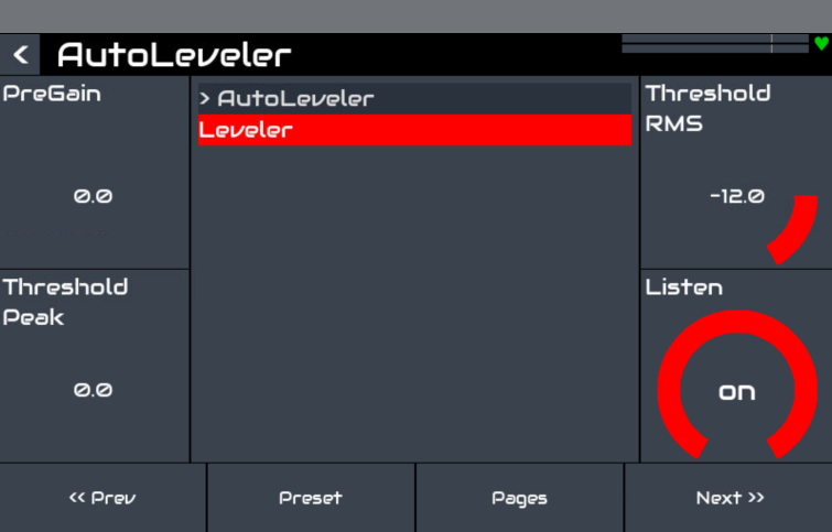

Here is my first zynthian plugin:
AutoLeveler (lv2 headless, v0.1.2beta)
It is an automatic downleveller sitting on a chain or the master chain. You set the peak and RMS threshold in dBfs, if the output exceeds that threshold it smoothly downlevels the output.
Why:
It can have two purposes: It may work as a security downleveller if anything before the chain pushes the volume in unhealthy manners (eg. on the master chain). The main purpose is to put it on every chain in your snapshot for equaling the outputs of very silent marimba soundfonts and very loud square wave synth leads alike. It processes peak and rms measurements.
How to use:
It features four controls:
  • Pre Gain (dBfs)
    Adjust the pre amplification in case you deal with quieter sources (like soundfonts) you want to boost before getting into the automatic levelling.
  • Theshold Peak (dBfs)
    Set your maximum peak levels you want to have. Setting the threshold will reset your former gain reduction so it can listen from the start again. When “Listen” is on, it will only turn the volume downwards. Recommended values are between 0 and -4 dBfs.
  • Theshold RMS (dBfs)
    Set your maximum RMS levels you want to have. Setting the threshold will reset your former gain reduction so it can listen from the start again. When “Listen” is on, it will only turn the volume downwards. The detector is estimating RMS values of a 300ms window by a using a lowpass filter. Recommended values are between -14 and -18 dBfs.
  • Listen (bool)
    When engaged (by default) it will perform detection and level matching. When disengaged it will keep the current gain, but will not further listen. If engaged again, the gain reduction will be reset.
You can think of it as your angry sound engineer in a live situation, both during soundcheck and during the gig. Initially it will turn your output volume down to a reasonable level. It will also do that if anything unforseen happens in the chain (you add another plugin which features an integer gain multiplier and is set to gain=20). When set the right values (try the preset “Tuned”) it should level any source to a loudness level somewhere into yellow meter territory.
It also features two programs:
  • Init: All set to zero. It will not perform anything unless your level is above 0 dBfs, which is always bad.
  • Tuned: Set the parameters to reasonable values: Pre Gain will boost the signal by +6 dB to compensate quiet engines like soundfonts, peak threshold is set to -4 dBfs and RMS to -18 dBFS to keep more or less transient heavy signals somewhere in yellow area of your mixer.
How is it working / Signal chain
Signal chain is like this: Pregain → Detector → Apply AutoGain → Calculate overshoots and set post gain processor.
During calculation it will chose the lower value of Peak/RMS detector and will only apply it in case the volume gets turned down. The Pre Gain features a parameter smoothing of 1000 samples (typically about 20 ms), the autogain processor uses 10000 samples (about 200 ms).

I added the listening parameter and leave this by now. You can turn the listening param off if you don’t currently want the plugin to listen and downlevel the volume, turning it on again resets the level and restarts the listening process.
(Deleted link because newest version is in first post)

Hi, I just compiled another version:
  • Updated the description in the first post of the thread to make things clearer.
  • Deleted pan parameter (not that important in that kind of plugin and also reduces parameter count four, one single page)
  • @jofemodo: There is a new binary which may mark the final state linked to the release page in the first post. Let me know if it would better suited just inside the repositories tree.
  • Last remark: I do enjoy the discussions with all of you. I’m open for any suggestions.
