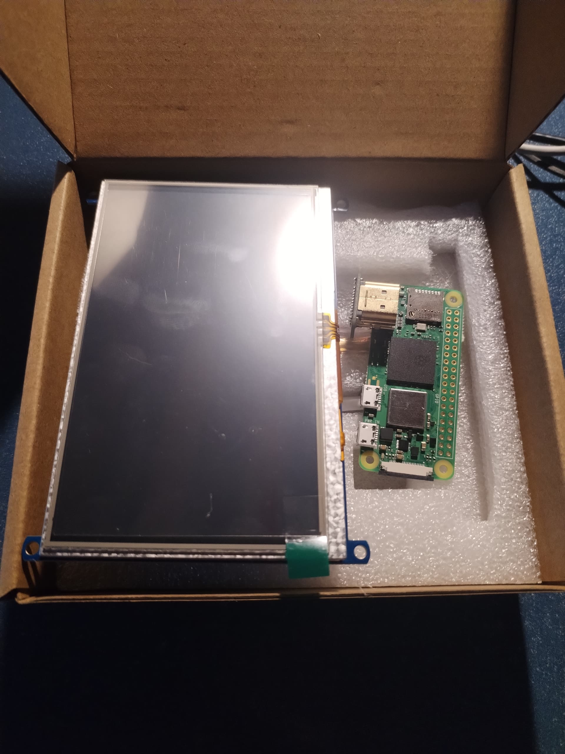

OK, I’m pretty new to Zynthian (it’s my first project using it, so I’m not sure if I even put it in good category), but not complete novice in DIY electronics and synthesis, since I already made few simple projects like this.

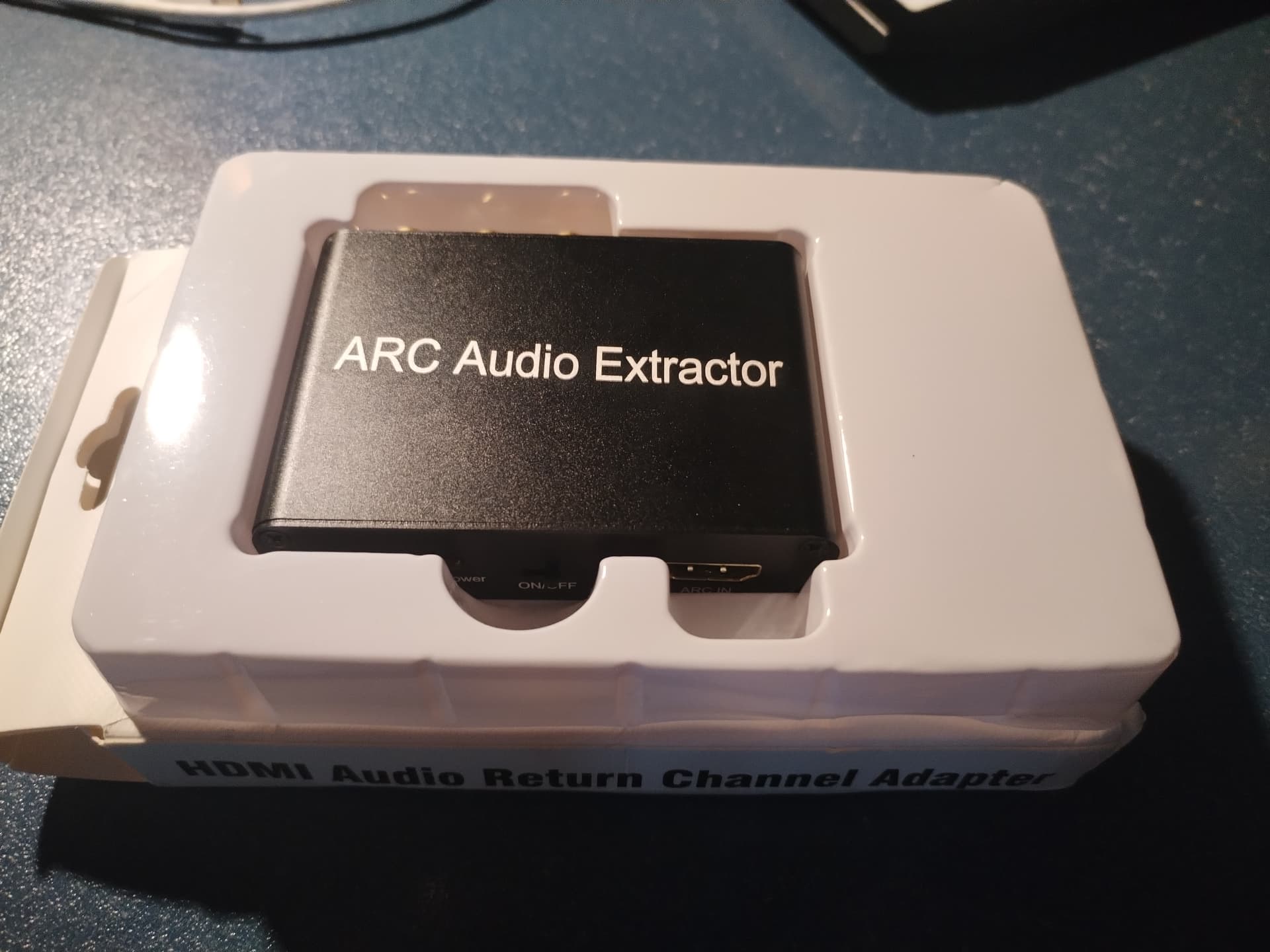

So my new idea was to use open source Hammond Novachord emulation I’ve found and install it somehow on RaspberryPi Zero 2W I just ordered, together with touch sensitive LCD panel I bought, and to separate audio signal from the HDMI interface using cheap-but-reliable HDMI Audio Return Channel Adapter bought from AliExpress. I may make some wooden enclosure (with laser cutter) for everything later, too. Ofc I have MIDI keyboard to control the whole Zynthian engine, too.
I want to know if such approach makes ANY sense, or should I try different way to implement this exact emulation on RPi? Is Zero 2W enough? Does signal path like “RPi –> Audio Channel HDMI separator –> Audio Out & LCD panel” make sense? Pics rel

This is a hard path and probably you will be almost alone in the dark. I would recommend a “standard” Pi4 or Pi5. Using HDMI audio output is not a good idea neither. We never got good results with this. I would recommend a decent I2S audio interface, specially if you want to perform and get good sound quality with low latency and little jitter. Indeed, if you want the lowest jitter, you should take care of using an audio interface with good clock generators.

You don’t need an all singing and dancing pi. I have a pi4 1GB and it’s fine. You’d almost be better with a pi zero than any other board because other SBC’s invariably need unique kernels, or drivers which won’t be in the zynthian image.
So, simply try running desired LV2 plugin on Pi Zero with any necessary software?
I don’t know enough about the pi 2 zero to answer that.
PiZero2 is an arm64 device, so it’s not far from pi3 or Pi4. Most sure is not going to work out-the-box, but It could work with some adjustments.
Probably enough power to run smoothly a single not-too-weight lv2 plugin. It could run the zynthian ui too. It would use about 20-30% of one core., and pi0-2 has 4. Good enough.
Good luck!
I wouldn’t recommend running zynthian on a PiZero2. It may be possible and there may be some users for whom this would be benefical, but you will have issues under some (many) conditions. If you only want to run a single plugin then you would be better to write a script to start the relevant applications, e.g. a LV2 host running the plugin and input/output routing.

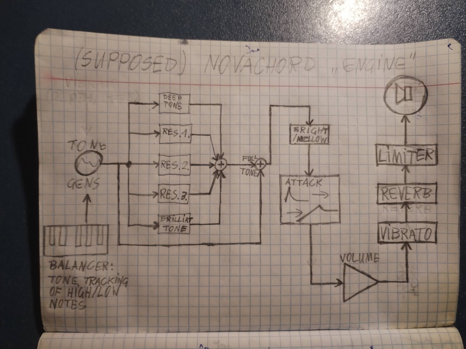

I figured out approximately how signal path in original Hammond Novachord most likely looks like:
