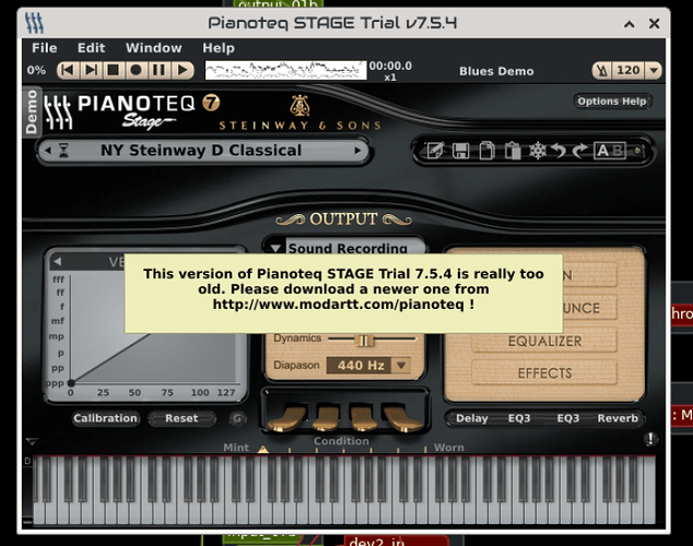

On a fresh installation of oram, installed with 2024-06-26-zynthianos-bookworm-aarch64-oram-2406, pianoteq gives no sound. When I inspected the program via vnc, I got this screen:
Then I updated it with the latest pianoteq stage, which is pianoteq_stage_linux_trial_v831.7z, which did work.
