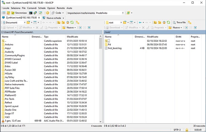

Concerning Step 3 I’d propose to copy it over with winscp (assuming you’re under Win as you talk about PuTTY), that might prevent some copy 'n paste errors…

Thanks @Tithrion and @ Aethermind

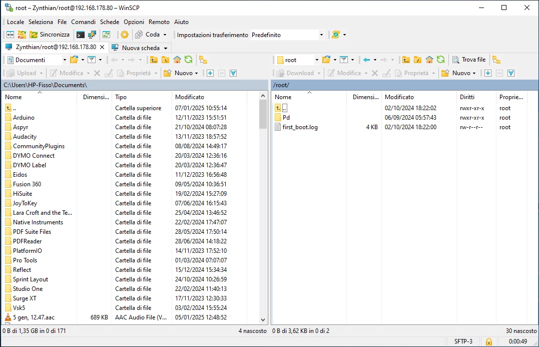

I had already installed WinSCP… but never used it with Zynthian… Where should I paste the @riban script? Thanks
