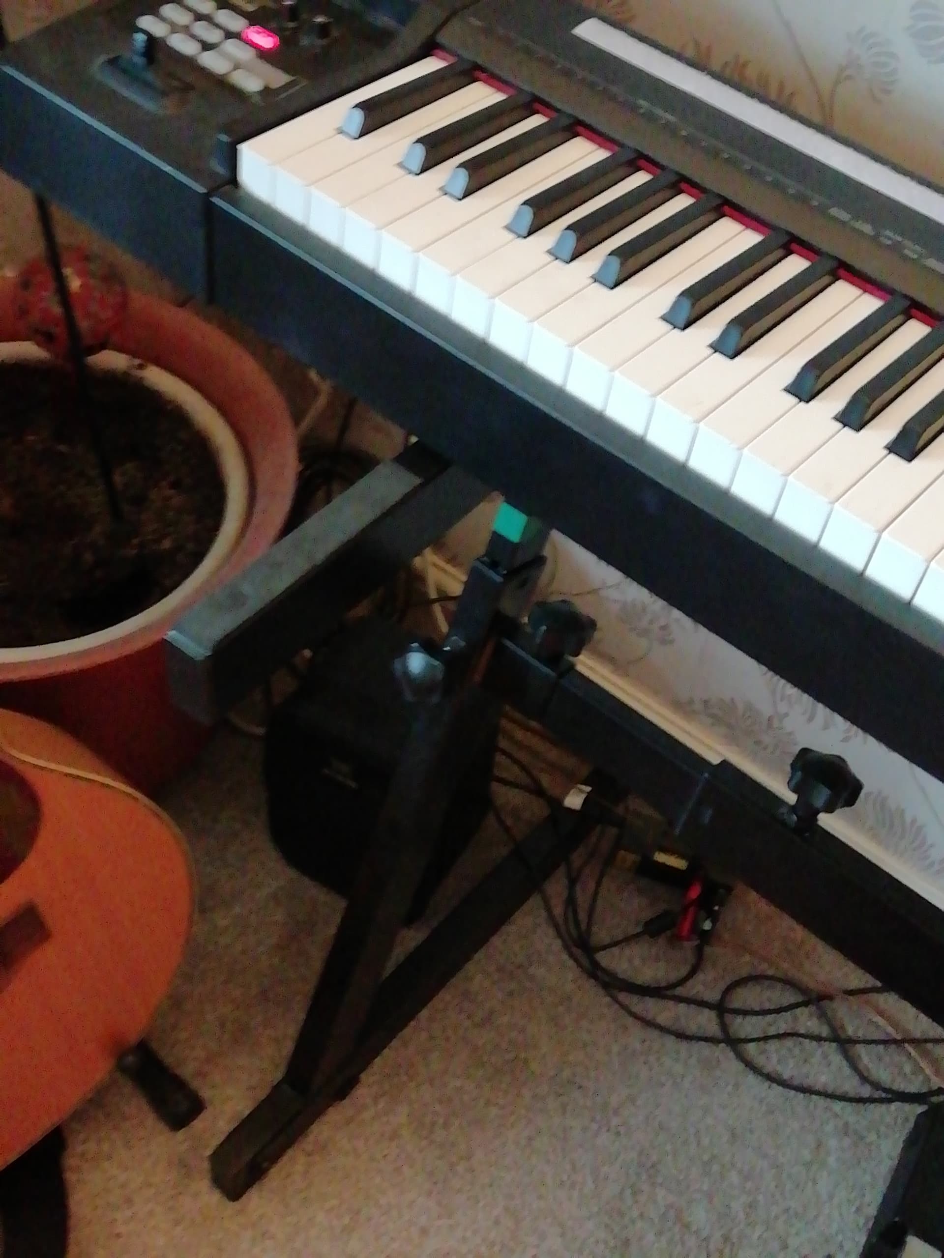

Add some speakers and it’s now a standalone instrument :smiley:
You mean like this?
The wyleu family piano. It’s run for six weeks… Hifiberry amp.
