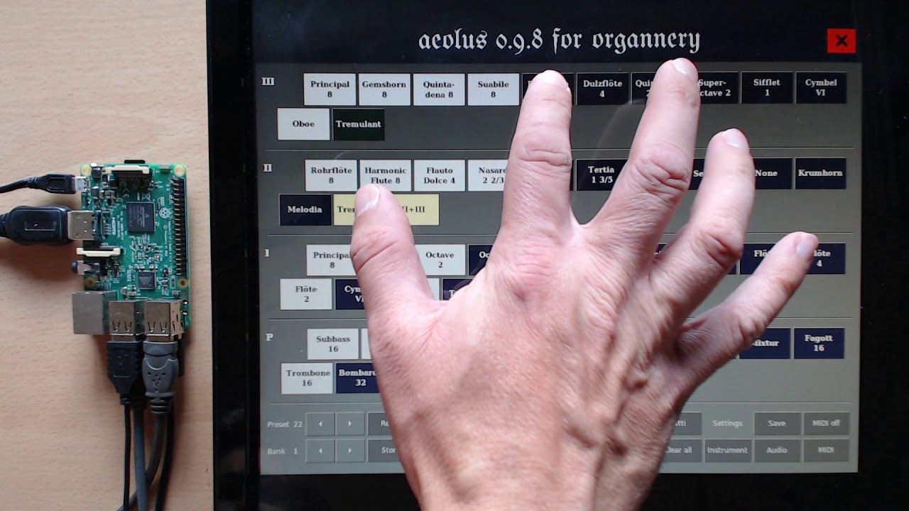

Some samples from the included Aeolus. You have “infinite” combinations with total control of all registers in 3 manuals + pedals. To my ears it sounds super-nice too:
Not my intention to troll the thread!
I included some Aeolus samples just as a reference to compare.
